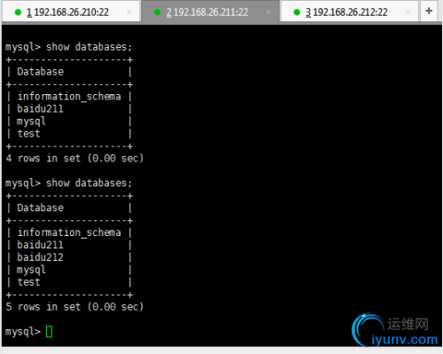

  配置MYSQL双主:192.168.26.211
  Vim /etc/my.cnf
  配置文件如下:
  [mysqld]
  datadir=/var/lib/mysql
  socket=/var/lib/mysql/mysql.sock
  user=mysql
  # Disabling symbolic-links is recommended to prevent assorted security risks
  symbolic-links=0
  server-id=211
  log-bin=mysq-bin
  relay-log=relay-bin
  [mysqld_safe]
  log-error=/var/log/mysqld.log
  pid-file=/var/run/mysqld/mysqld
  创建远程所有权账号:

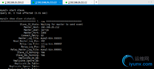

  grant replication slave,replication client on *.* to 'jerry'@'192.168.%.%'>

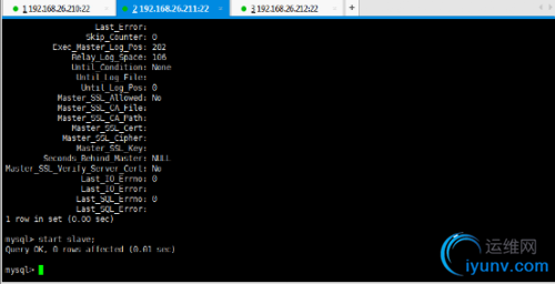

  change master to master_host='192.168.26.212',master_user='jerrys',master_password='jerrypass',master_log_file='mysql-bin.000001',master_log_pos=282;
  Start slave;

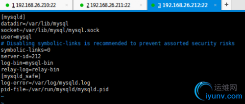

  双主配置:192.168.26.212
  Vim /etc/my.cnf
  配置文件如下:
  [mysqld]
  user=mysql
  symbolic-links=0
  server-id=212
  log-bin=mysql-bin
  relay-log=relay-bin
  [mysqld_safe]
  pid-file=/var/run/mysqld/mysqld.pid

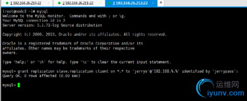

  授权远程访问账号:

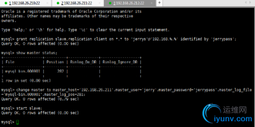

  change master to master_host='192.168.26.211',master_user='jerry',master_password='jerrypass',master_log_file='mysql-bin.000001',master_log_pos=281;
  Start slave;
