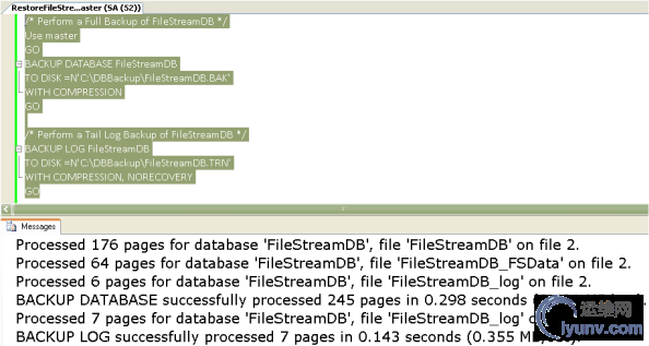

  Backup FILESTREAM Enabled Database
  A DBA can perform a full backup of a FileStreamDB database by executing the T-SQL Code below.  In this tip, all of the backups are using the database backup compression feature which was introduced in SQL Server 2008.
/* Perform a Full Backup of FileStreamDB */  Use master
  GO
  BACKUP DATABASE FileStreamDB
  TO DISK =N'C:\DBBackup\FileStreamDB.BAK'
  WITH COMPRESSION
  GO
  /* Perform a Tail Log Backup of FileStreamDB */
  BACKUP LOG FileStreamDB
  TO DISK =N'C:\DBBackup\FileStreamDB.TRN'
  WITH COMPRESSION, NORECOVERY
  GO
