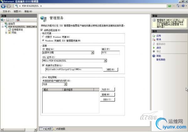

  2.在Win2008R2 IIS7.0的"功能视图"最后找到 "管理服务"然后启动设置远程管理服务:

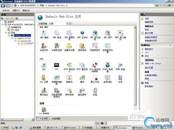

  不过,这一缺陷在IIS 7.0中得到了很大的改善,在这一新版IIS中,管理员可以使用图形化管理工具来管理大量的网站,下面我来看一下IIS管理器。
图9、MMC 图形模式管理工具

图10、启动设置远程管理服务

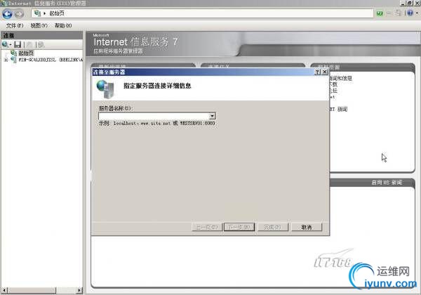

图11、从客户端连接远程服务器

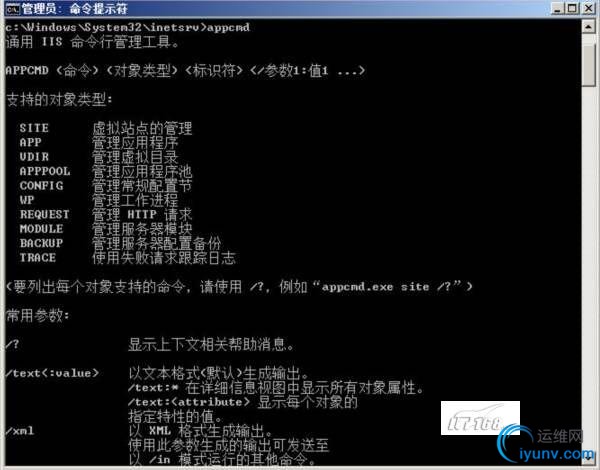

    除了图形化的管理工具之外,微软还为IIS 7.0提供了一个命令行管理工具,以满足站点比较多的用户进行批量操作。
图12、IIS命令行管理工具

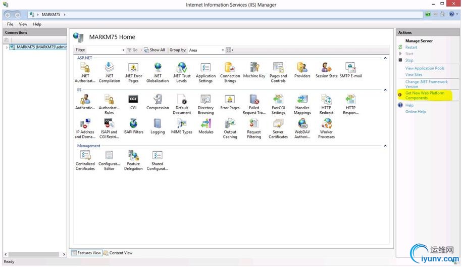

After you have the IIS manager components installed from Programs and Features you simply open the IIS Manager and look on the right hand side for "Get New Web Platform Components".
  Click that link as below.

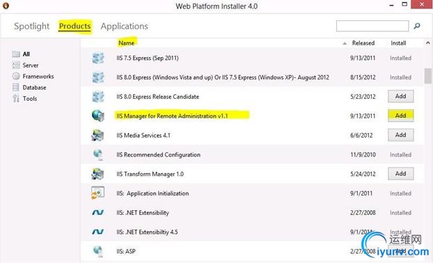

  This opens the Web Platform Installer 4.0.  If you click Products andsort by name you will find IIS Manager for Remote Administration v1.1. Click Add as shown below.

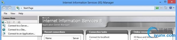

DSC0007.jpg   After the install is complete you can then use the Connections icon and one of the options such as "Connect to a Server", "Connect to Site",or "Connect to an Application" from the interface.
