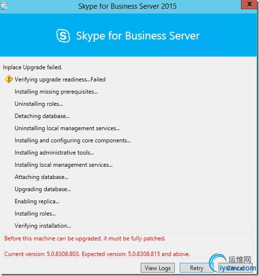

  If your server does not meet the requirements the upgrade readiness check will fail.

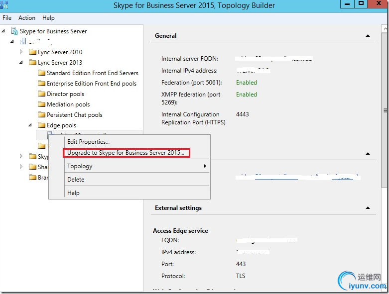

  • Locate your Edge server in the menu to the left and right click and select “Upgrade to Skype for Business 2015…” DSC0001.png

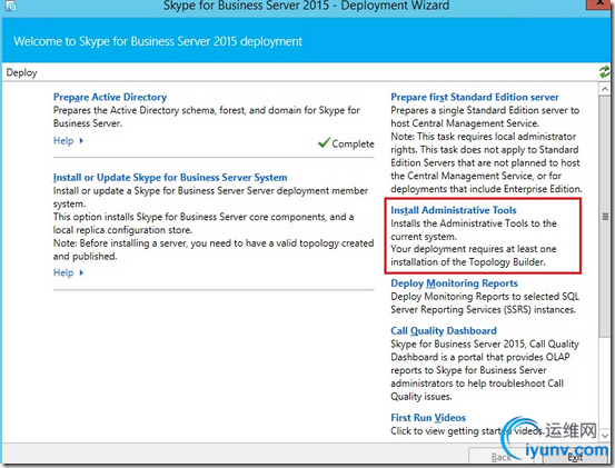

  • Once the core components are installed. Open the Deployment Wizard (should open automatically) and install the Administrative tools

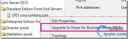

  7. Locate your front end server in the menu, right click and select “Upgrade to Skype for Business 2015…”

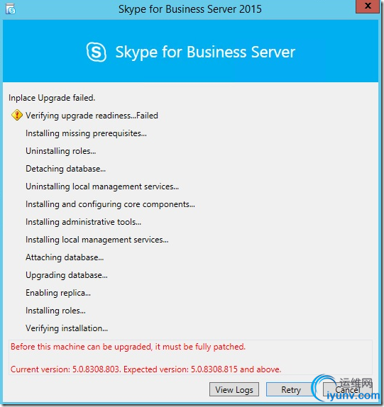

  Failure to perform the above will result in the upgrade readiness check to fail.
