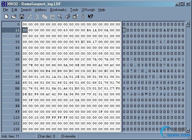

12SHUTDOWN WITH NOWAIT;GO  Now that SQL Server is shutdown, I’m going to simulate an I/O failure that corrupts the log file. I’m going to use a hex editor to do this – my editor of choice is the immensely popular and useful XVI32, written by Christian Maas. I opened the log file, filled the first section with zeroes, and then saved it again. See the screenshot below. (As a small note of warning, this hex editor will truncate files that are over 2GB. Used the HxD editor instead for larger files.)
