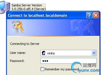

      First try to login from user nikita she will not successes as nikita have not permission to login

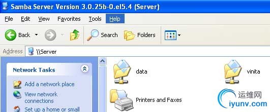

      Now login from user vinita [ give the password which you set with smbpasswd command ]
      As you can see in image user vinita gets the /data folder which we share from samba server
