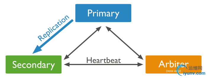

  部署架构如下:
  A.分别配置mongo-sharding-replica1,mongo-sharding-replica2和mongo-sharding-replica3的MongoDB的配置文件和启动脚本并启动MongoDB
