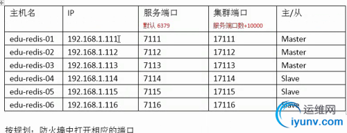

  •   要求6台服务器
  三主三从

  具体实验步骤
  说明:视频上用的是
  192.168.1.0/24   我自己用的是 192.168.56.0/24 网段
  redis 集群的通讯的端口默认是服务端口加上10000

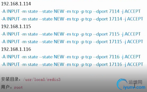

  1.所有机器 停止selinux 和 iptables (iptables 有的话端口允许)(all)
  yum  -y install  gcc  ctl

  5. 初始化操作
  mkdir  -p /usr/local/redis3/cluster/7111    #192.168.56.111
  mkdir  -p /usr/local/redis3/cluster/7112   #192.168.56.112
  mkdir  -p /usr/local/redis3/cluster/7113  #192.168.56.113
  mkdir  -p /usr/local/redis3/cluster/7114   #192.168.56.114
  mkdir  -p /usr/local/redis3/cluster/7115  #192.168.56.115
  mkdir  -p /usr/local/redis3/cluster/7116   #192.168.56.116
  scp redis.conf 192.168.56.111:/usr/local/redis3/cluster/7111/redis-7111.conf
  scp redis.conf 192.168.56.112:/usr/local/redis3/cluster/7112/redis-7112.conf
  scp redis.conf 192.168.56.113:/usr/local/redis3/cluster/7113/redis-7113.conf
  scp redis.conf 192.168.56.114:/usr/local/redis3/cluster/7114/redis-7114.conf
  scp redis.conf 192.168.56.115:/usr/local/redis3/cluster/7115/redis-7115.conf
  scp redis.conf 192.168.56.116:/usr/local/redis3/cluster/7116/redis-7116.conf
