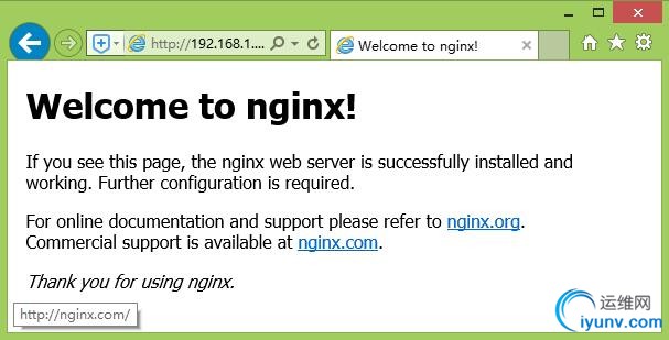

  启动nginx
  [root@www nginx-1.9.6]# nginx
  [root@www nginx-1.9.6]# netstat -tlnp |grep nginx
  tcp        0      0 0.0.0.0:80                  0.0.0.0:*                   LISTEN      4554/nginx

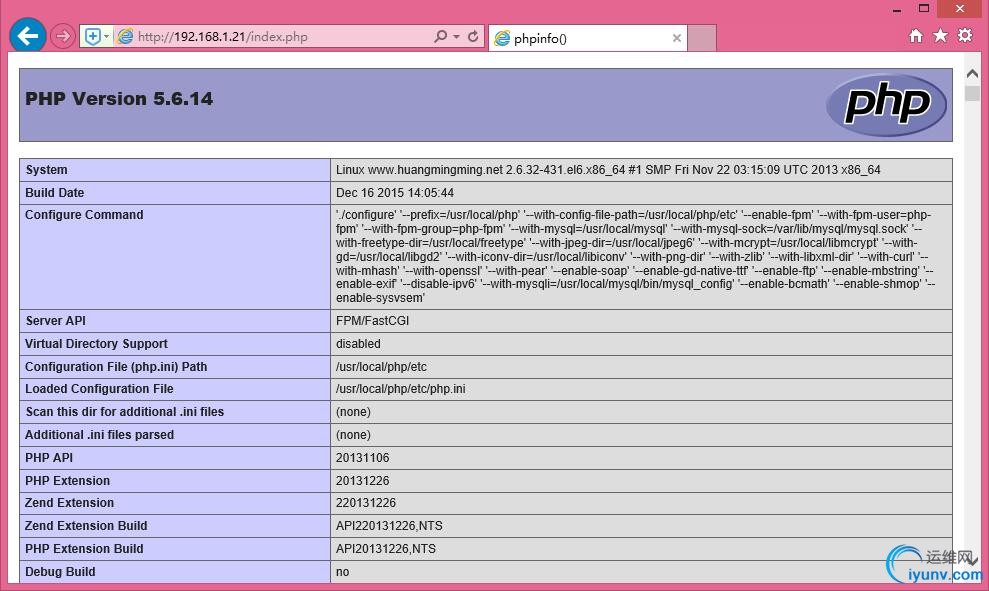

  php-fpm启动报错
  Starting php-fpm [18-Dec-2015 13:33:03] ERROR: unable to bind listening socket for address '127.0.0.1:9000': Address already in use (98)
  [18-Dec-2015 13:33:03] ERROR: FPM initialization failed
  failed
  [root@www nginx-1.9.6]# /usr/local/php/sbin/php-fpm -t
  [18-Dec-2015 13:35:14] NOTICE: configuration file /usr/local/php/etc/php-fpm.conf test is successful
  [root@www nginx-1.9.6]# killall php-fpm
  [root@www nginx-1.9.6]# service php-fpm start
  Starting php-fpm  done
  重新加载配置
  [root@www nginx-1.9.6]# nginx -t
  nginx: the configuration file /etc/nginx/nginx.conf syntax is ok
  nginx: configuration file /etc/nginx/nginx.conf test is successful
  [root@www nginx-1.9.6]# nginx -s>  测试php解析
  [root@www nginx-1.9.6]# vim /usr/local/nginx/html/index.php
