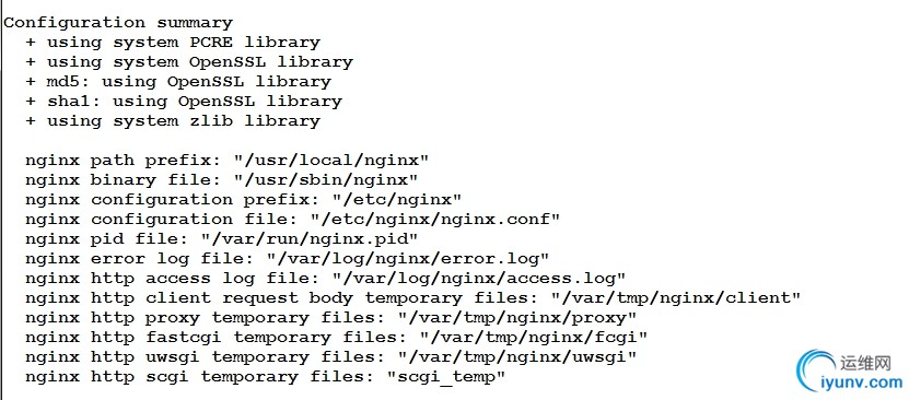

  编译nginx
  cd /usr/src/nginx-1.8.0
  sudo ./configure --prefix=/usr/local/nginx \
  --sbin-path=/usr/sbin/nginx \
  --conf-path=/etc/nginx/nginx.conf \
  --error-log-path=/var/log/nginx/error.log \
  --http-log-path=/var/log/nginx/access.log \
  --pid-path=/var/run/nginx.pid \
  --lock-path=/var/lock/nginx.lock \
  --user=nginx \
  --group=nginx \
  --with-http_ssl_module \
  --with-http_flv_module \
  --with-http_stub_status_module \
  --http-client-body-temp-path=/var/tmp/nginx/client \
  --http-proxy-temp-path=/var/tmp/nginx/proxy \
  --http-fastcgi-temp-path=/var/tmp/nginx/fcgi \
  --http-uwsgi-temp-path=/var/tmp/nginx/uwsgi \
  --with-pcre
  错误:
  ./configure:error: the HTTP rewrite module requires the PCRE library.
  You can either disable the module by using--without-http_rewrite_module
  option, or install the PCRE library intothe system, or build the PCRE library
  statically from the source with nginx byusing --with-pcre= option.
  缺少pcre-devel包
  解决:
  Centos :yum installpcre-devel  就可以解决
  Ubuntu : sduo apt-get pcre-devel  找不到pcre-devel包,debian/ubuntu系统下名称改了,名称为libpcre3 libpcre3-dev 正确命令如下:
  sudoapt-get install libpcre3 libpcre3-dev
  继续编译nginx
  错误:
  ./configure: error: SSL modules require the OpenSSL library.
  You can either do not enable the modules,or install the OpenSSL library
  into the system, or build the OpenSSLlibrary statically from the source
  with nginx by using --with-openssl=option.
  缺少openssl libssl-dev包
  解决:
  Centos:yum install openssl-devel
  Ubuntu: sudo apt-get install openssl libssl-dev
  重新编译成功

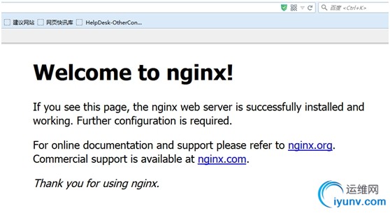

  访问测试
