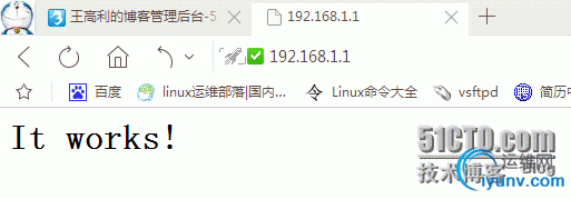

iptables:将防火墙规则保存到 /etc/sysconfig/iptables:     [确定]  7.测试
