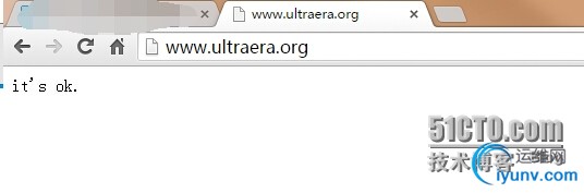

[Alex@Test01 ~]# sudo chkconfig httpd on     # set httpd start with system.  3.create a HTML test page and access to it with a web browser on Client to make sure it works normally.
[Alex@Test01 ~]# sudo vi /var/www/html/index.html
it's ok.  4.test Page.

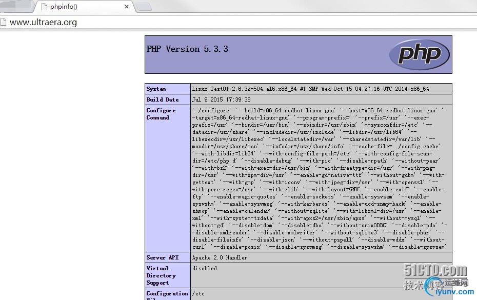

Starting httpd:[  OK  ]  6. create a php test page and access to it with a web browser on client to make sure it works normally.
[Alex@Test01 ~]# sudo vi /var/www/html/index.php
  7.test Page.
