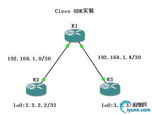

静态路由的缺点是,必须手工配置,同时在网络拓扑变化后需要手工更新;动态路由的缺点是,它们需要占用网络带宽和路由器资源。在包含数百个分支站点的中央-分支网络,采用静态路由时配置工作量将非常大,而采用动态路由时将占用大量的资源。
在这种情况下,我们采用第三种方式——按需路由(ODR,On Demand Routing)。ODR是Cisco的私有协议,它使用CDP在分支路由器和中央路由器之间传输网络信息。它的优点是,比动态路由协议开销小得多,比静态路由协议配置量少得多。而它的缺点就是,只适合于中央-分支拓扑。
在中央路由器的全局模式下使用router odr命令来启用ODR。
下面是ODR配置示例:
R1配置如下:
R1#sh run

用R2去ping R3,测试连通性:
R2#ping 3.3.3.3
Type escape sequence to abort.
Sending 5, 100-byte ICMP Echos to 3.3.3.3, timeout is 2 seconds:
Success rate is 100 percent (5/5), round-trip min/avg/max = 60/62/64ms
查看R1的路由表:
R1#sh ip route
Codes: C - connected, S - static, R - RIP, M - mobile, B - BGP
       D - EIGRP, EX - EIGRPexternal, O - OSPF, IA - OSPF inter area
       N1 - OSPF NSSA externaltype 1, N2 - OSPF NSSA external type 2
       E1 - OSPF external type1, E2 - OSPF external type 2
       i - IS-IS, su - IS-ISsummary, L1 - IS-IS level-1, L2 - IS-IS level-2
       ia - IS-IS inter area,* - candidate default, U - per-user static route
       o - ODR, P - periodicdownloaded static route
Gateway of last resort is not set
     2.0.0.0/32 is subnetted,1 subnets
o       2.2.2.2 [160/1] via192.168.1.2, 00:00:22, FastEthernet0/0
     3.0.0.0/32 is subnetted,1 subnets
o       3.3.3.3 [160/1] via192.168.1.6, 00:00:27, FastEthernet0/1
     192.168.1.0/30 issubnetted, 2 subnets
C       192.168.1.0 isdirectly connected, FastEthernet0/0
C       192.168.1.4 isdirectly connected, FastEthernet0/1
查看R2的路由表:
R2#sh ip route
       E1 - OSPF external type 1, E2 - OSPFexternal type 2
Gateway of last resort is 192.168.1.1 to network 0.0.0.0
C       2.2.2.2 is directlyconnected, Loopback0
     192.168.1.0/30 issubnetted, 1 subnets
o*   0.0.0.0/0 [160/1] via 192.168.1.1, 00:00:16, FastEthernet0/0
查看R3的路由表:
R3#sh ip route
Gateway of last resort is 192.168.1.5 to network 0.0.0.0
C       3.3.3.3 is directlyconnected, Loopback0
o*   0.0.0.0/0 [160/1] via 192.168.1.5, 00:00:45, FastEthernet0/1
