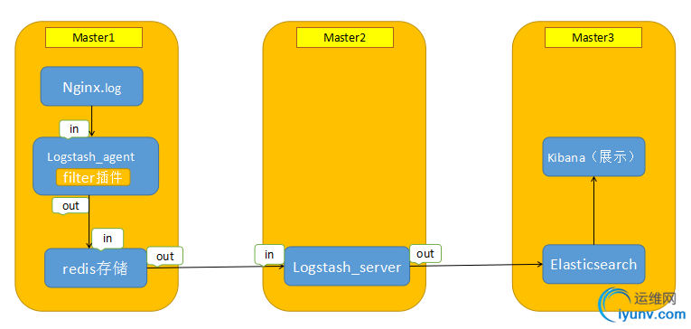

master1作为logstash_agent端,master1运行WEB网站。master2为logstash服务端,master3为Elasticsearch

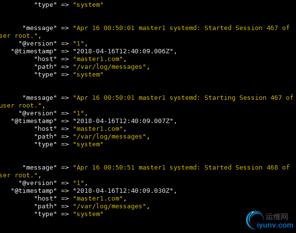

[root@master1 ~]# vim /etc/logstash/conf.d/filesample.conf
input {
file {
path => ["/var/log/messages"]
type => "system"
start_position => "beginning"
output {
stdout {
codec   => rubydebug
语法测试:
[root@master1 ~]# logstash -f /etc/logstash/conf.d/filesample.conf --configtest
Configuration OK
运行:
  file插件官网链接:
https://www.elastic.co/guide/en/logstash/1.5/plugins-inputs-file.html
  结束:Ctrl+c

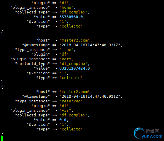

2.2 udp
master2安装 collectd,配置其network插件,向外发送数据。
[root@master2 ~]# yum install collectd
配置collectd
[root@master2 ~]# vim /etc/collectd.conf
#定义主机名
Hostname    "master2.com"
#打开几个监控项
LoadPlugin cpu
LoadPlugin df
LoadPlugin interface
LoadPlugin load
LoadPlugin memory
LoadPlugin network
定义发送到logstash端的监听端口
启动服务
[root@master2 ~]# systemctl start collectd.service
logstash端配置:
[root@master1 ~]# vim /etc/logstash/conf.d/udpsample.conf
input {
udp {
port    => 25826
codec   => collectd {}
type    => "collectd"
output {
stdout {
codec   => rubydebug
语法检测:
[root@master1 ~]# logstash -f /etc/logstash/conf.d/udpsample.conf --configtest
Configuration OK
启动:
Logstash startup completed

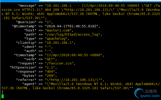

2.4 apachelogs
[root@master1 ~]# vim /etc/logstash/conf.d/apachelogssample.conf
input {
file {
path    => ["/var/log/httpd/access_log"]
type    => "apachelog"
filter {
grok {
match   => { "message" => "%{COMBINEDAPACHELOG}" }
output {
stdout {
codec   => rubydebug
[root@master1 ~]# logstash -f /etc/logstash/conf.d/apachelogssample.conf --configtest
Configuration OK
运行测试:
访问apache主页:http://10.201.106.131

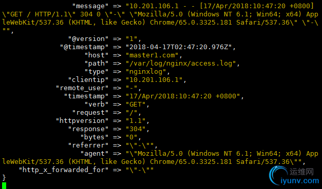

2.5 nginxlog
编辑pattern
[root@master1 ~]# vim /opt/logstash/vendor/bundle/jruby/1.9/gems/logstash-patterns-core-0.3.0/patterns/grok-patterns
# Nginx Logs
NGUSERNAME [a-zA-Z\.\@\-\+_%]+
NGUSER %{NGUSERNAME}
NGINXACCESS %{IPORHOST:clientip} - %{NOTSPACE:remote_user} \[%{HTTPDATE:timestamp}\] \"(?:%{WORD:verb} %{NOTSPACE:request} (?: HTTP/%{NUMBER:httpversion})?|%{DATA:rawrequest})\" %{NUMBER:response} (?:%{NUMBER:bytes} |-) %{QS:referrer} %{QS:agent} %{NOTSPACE:http_x_forwarded_for}
安装启动nginx:
[root@master1 ~]# systemctl stop httpd.service
[root@master1 ~]# yum install nginx
[root@master1 ~]# systemctl start nginx.service
logstash配置:
[root@master1 ~]# cd /etc/logstash/conf.d/
[root@master1 conf.d]# cp apachelogssample.conf nginxlogsample.conf
[root@master1 conf.d]# vim nginxlogsample.conf
input {
file {
path    => ["/var/log/nginx/access.log"]
type    => "nginxlog"
filter {
grok {
match   => { "message" => "%{NGINXACCESS}" }
output {
stdout {
codec   => rubydebug
运行测试:
[root@master1 ~]# logstash -f /etc/logstash/conf.d/nginxlogsample.conf
3、output插件
3.1 redis存入数据
安装redis

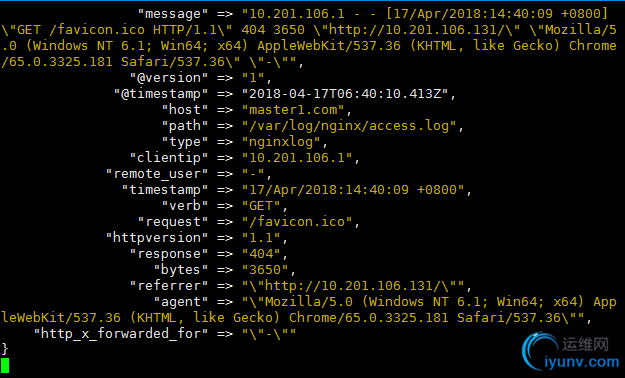

运行测试:
[root@master1 ~]# logstash -f /etc/logstash/conf.d/nglogredissample.conf
再次访问nginx主页,http://10.201.106.131
查看redis:

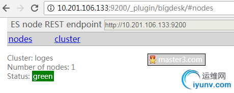

安装插件(方便查看状态):
[root@master3 ~]# /usr/share/elasticsearch/bin/plugin -i bigdesk -u file:///root/bigdesk-latest.zip
[root@master3 ~]# /usr/share/elasticsearch/bin/plugin -l
Installed plugins:
- bigdesk
测试访问插件:

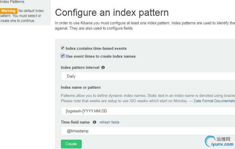

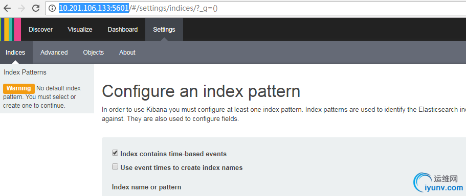

3.3.2 Kibana(前端展示)
  下载链接:https://www.elastic.co/downloads/past-releases
[root@master3 ~]# ls
kibana-4.1.2-linux-x64.tar.gz
解压到/usr/local
[root@master3 ~]# tar xf kibana-4.1.2-linux-x64.tar.gz -C /usr/local/
[root@master3 local]# ln -sv kibana-4.1.2-linux-x64 kibana
‘kibana’ -> ‘kibana-4.1.2-linux-x64’
配置:
[root@master3 config]# pwd
/usr/local/kibana/config
[root@master3 config]# vim kibana.yml
#修改其中一个节点的IP或者node名字,如果是本机直接localhost
elasticsearch_url: "http://10.201.106.133:9200"
运行(如需运行后台,在命令后门加&即可):
[root@master3 ~]# /usr/local/kibana/bin/kibana
访问:
http://10.201.106.133:5601

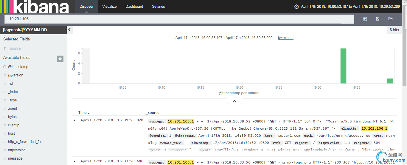

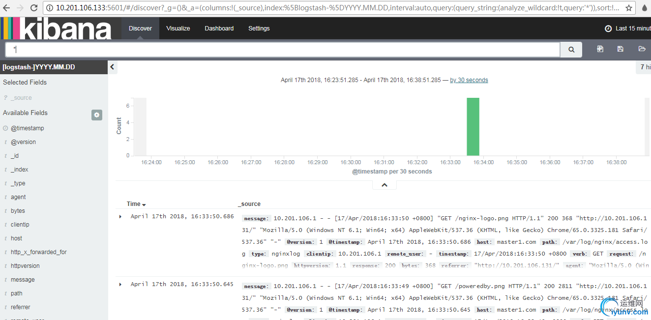

3.3.3 配置logstash输出到Elasticsearch
[root@master2 ~]# vim /etc/logstash/conf.d/server.conf
input {
redis {
port    => "6379"
host    => "10.201.106.131"
data_type   => "list"
key     => "logstash-nginxlog"
output {
elasticsearch {
cluster => "loges"
index   => "logstash-%{+YYYY.MM.dd}"
语法测试(尽量使用java8)
[root@master2 ~]# logstash -f /etc/logstash/conf.d/server.conf --configtest
[2018-04-18 01:42:55.146]  WARN -- Concurrent: [DEPRECATED] Java 7 is deprecated, please use Java 8.
Java 7 support is only best effort, it may not work. It will be removed in next release (1.0).
Configuration OK
启动(会自动发现Elasticsearch节点):

3.3.4 配置Kibana
  可进行搜索:
3.3.5 服务后台运行
