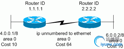

OSPF Routers Connected by an Unnumbered Serial Link
发表于 2015-5-25 11:19:43 | 显示全部楼层 |阅读模式

Link connected to: another Router (point-to-point)
!--- This line shows that this router (1.1.1.1) is a neighbor
!--- with 2.2.2.2.
(Link ID) Neighboring Router ID: 2.2.2.2
(Link Data) Router Interface address: 0.0.0.12
!--- In the case of unnumbered link, use the MIB II IfIndex
!--- value. This value usually starts with 0.
Number of TOS metrics: 0
TOS 0 Metrics: 64
