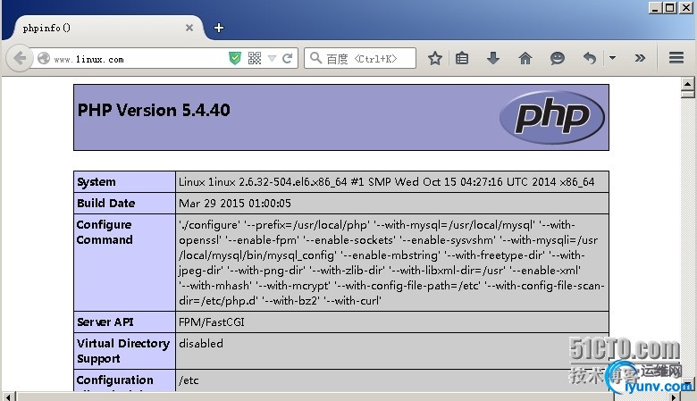

四、编译安装php-5.4.4
1、解决依赖关系并编译安装:
安装依赖程序包
[iyunv@1inux php-5.4.40]# tar xf php-5.4.40.tar.bz2
[iyunv@1inux php-5.4.40]# cd php-5.4.40
[iyunv@1inux php-5.4.40]# yum install bzip2 bzip2-devel -y
[iyunv@1inux php-5.4.40]# yum install mhash mhash-devel mcrypt -y
[iyunv@1inux php-5.4.40]# yum -y install libxml2 libxml2-devel
[iyunv@1inux php-5.4.40]# yum -y install curl-devel
[iyunv@1inux php-5.4.40]# yum install libmcrypt libmcrypt-devel -y
编译安装
[iyunv@1inux php-5.4.40]# ./configure --prefix=/usr/local/php --with-mysql=/usr/local/mysql --with-openssl --enable-fpm --enable-sockets --enable-sysvshm  --with-mysqli=/usr/local/mysql/bin/mysql_config --enable-mbstring --with-freetype-dir --with-jpeg-dir --with-png-dir --with-zlib-dir --with-libxml-dir=/usr --enable-xml  --with-mhash --with-mcrypt  --with-config-file-path=/etc --with-config-file-scan-dir=/etc/php.d --with-bz2 --with-curl
[iyunv@1inux php-5.4.40]# make && make install
2、为php提供配置文件
[iyunv@1inux php-5.4.40]# cp php.ini-production /etc/php.ini
3、为php-fpm提供Sysv init脚本
[iyunv@1inux php-5.4.40]# cp sapi/fpm/init.d.php-fpm  /etc/rc.d/init.d/php-fpm
[iyunv@1inux php-5.4.40]# chmod +x /etc/rc.d/init.d/php-fpm
4、并将其添加至服务列表
[iyunv@1inux php-5.4.40]# chkconfig --add php-fpm
[iyunv@1inux php-5.4.40]# chkconfig php-fpm on
5、为php-fpm提供配置文件
[iyunv@1inux php-5.4.40]# cp /usr/local/php/etc/php-fpm.conf.default /usr/local/php/etc/php-fpm.conf
6、编辑php-fpm的配置文件:
[iyunv@1inux php-5.4.40]# vim /usr/local/php/etc/php-fpm.conf
配置fpm的相关选项为你所需要的值,并启用pid文件(如下最后一行):
pm.max_children = 150
pm.start_servers = 8
pm.min_spare_servers = 5
pm.max_spare_servers = 10
pid = /usr/local/php/var/run/php-fpm.pid
7、现在就可以启动php-fpm了
[iyunv@1inux php-5.4.40]# service php-fpm start
8、验证是否启动成功 (如果此命令输出有中几个php-fpm进程就说明启动成功了):
[iyunv@1inux php-5.4.40]# ps aux | grep php-fpm
root     121717  0.0  0.4 253684  4308 ?        Ss   03:19   0:00 php-fpm: master process (/usr/local/php/etc/php-fpm.conf)
nobody   121800  0.7  2.2 259076 20700 ?        S    03:24   0:17 php-fpm: pool www
nobody   121816  0.4  2.5 261892 23372 ?        S    03:28   0:08 php-fpm: pool www
nobody   121817  0.3  2.2 259076 20700 ?        S    03:28   0:07 php-fpm: pool www
五、整合nginx和php5

4、接下来创建index.php页面,测试php是否能正常工作
[iyunv@1inux nginx]# vim  /usr/local/nginx/html/index.php
<?php
phpinfo();
5、访问主页
能够正常访问,说明 nginx+ php  已经配置完成

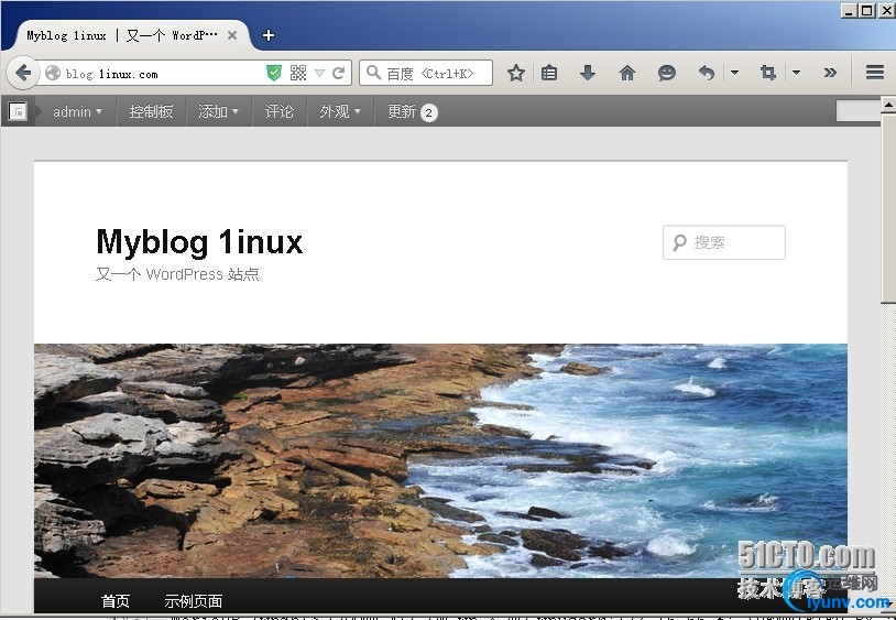

6、在nginx中添加虚拟主机配置WordPress blog
编辑配置文件/etc/nginx/nginx.conf,添加如下内容:server {
9
10
11
12
13
14
15
16
17
        listen 80;
        server_name blog.1inux.com;
        access_log logs/blog.access;  //其日志目录为: /usr/local/nginx/logs/blog.access
        error_log logs/blog.error;
        location / {
                root /vhost/blog;
                index index.php index.html index.htm;
        location ~ \.php$ {
            root           /vhost/blog;
            fastcgi_pass   127.0.0.1:9000;
            fastcgi_index  index.php;
            #fastcgi_param  SCRIPT_FILENAME  /scripts$fastcgi_script_name;
            fastcgi_param  SCRIPT_FILENAME  $document_root$fastcgi_script_name;
            include        fastcgi_params;
创建目录
# mkdir -pv /vhost/blog/
# unzip wordpress-3.2.1-zh_CN.zip
# mv wordpress/* /vhost/blog/
# chown -R nginx:nginx /vhost/blog
创建数据库及数据库用户密码
[iyunv@1inux ~]# mysql
MariaDB [(none)]> create database wpdb;
MariaDB [(none)]> GRANT ALL ON wpdb.* TO wpuser@'localhost' IDENTIFIED BY 'wppass';
MariaDB [wpdb]> GRANT ALL ON wp.* TO wpuser@'172.16.66.%' IDENTIFIED BY 'wppass';
然后安装.......访问
