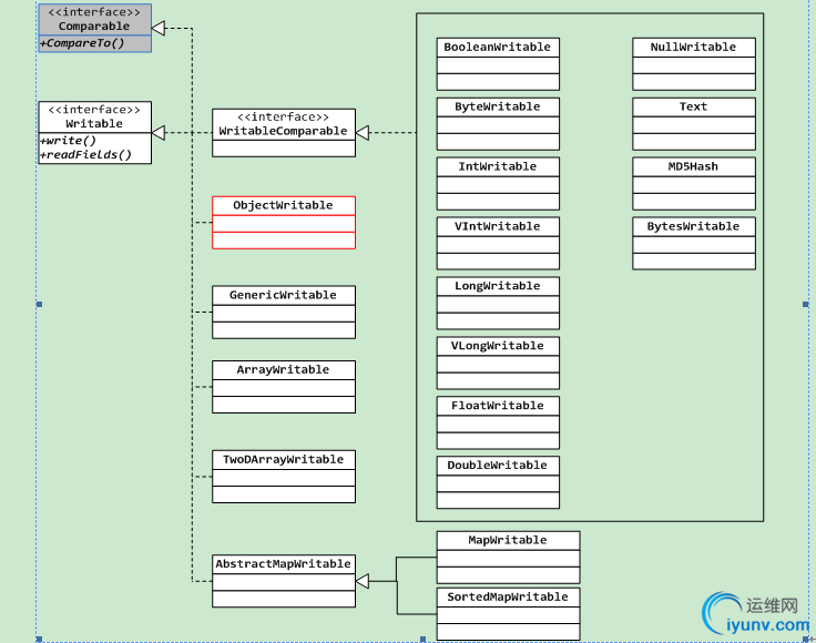

  3. Writable Classes
  Hadoop提供的可序列化的类型主要分成如下几种:
  1)  Java基本数据类型
  There are  Writable wrappers  for all  the  Java primitive  types  exceptshort and char (both of which can be stored in an IntWritable). All have a get() and a set() method for retrieving and storing the wrapped value.
  Java 基本数据类型
  Writable实现
  Serialized size(bytes)
  boolean
  BooleanWritable
  byte
  ByteWritable
  int
  IntWritable
  VIntWritable
  1-5
  float
  FloatWritable
  long
  LongWritable
  VLongWritable
  1-9
  double
  DoubleWritable
  2)  Text
  Text is a Writable for UTF-8 sequences, the max length is 2GB, 这个类的系列化和反序列化都是比较显而易见的,实现上大部分代码在做 UTF-8编解码和String(java中的String用的是unicode)的转换等。
  3)  BytesWritable
  BytesWritable is a wrapper for an array of binary data. Its serialized format is an integer field (4 bytes) that specifies the number of bytes to follow, followed by the bytes them-
  selves. For example, the byte array of length two with values 3 and 5 is serialized as a
  4-byte integer (00000002) followed by the two bytes from the array (03 and 05):
  BytesWritable b = new BytesWritable(new byte[] { 3, 5 });
  byte[] bytes = serialize(b);
  assertThat(StringUtils.byteToHexString(bytes), is("000000020305"));
  BinaryComparable是针对array of binary data而设计的比较器!
  4)  NullWritable
  NullWritable is a special type of Writable, as it has a zero-length serialization. No bytes are written to, or read  from, the stream. It  is used as a placeholder; forexample, in MapReduce, a key or a value can be declared as a NullWritable when you don’t need to use that position—it effectively stores a constant empty value.
  5)  ObjectWritableGenericWritable
  ObjectWritableis a general-purpose wrapper for the following: Java primitives, String, enum, Writable, null, or arrays of any of these types. It is used in Hadoop RPC to marshal(包装) and unmarshal method arguments and return types. 其实主要的通途就是对多于1个的域组成对象进行序列化!在对端进行反序列化的时候用到了WritableFactory和WritableFactories(用来根据类名来生成对象)
  6)  Writable Collections
  Thereare four Writable collection types in the org.apache.hadoop.io package:Array Writable, TwoDArrayWritable, MapWritable, and SortedMapWritable.
  ArrayWritable and  TwoDArrayWritable  are  Writable  implementations  for  arrays  andtwo-dimensional arrays (array of arrays) of Writable instances. All the elements of an
  ArrayWritable or a TwoDArrayWritable must be  instances of  the same class, which  is
  specified at construction, as follows:
  ArrayWritable writable = new ArrayWritable(Text.class);
  MapWritableand SortedMapWritable are implementations of java.util.Map and java.util.SortedMap, respectively. The type of each key and value field is a part of the serialization format for that field.
