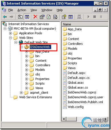

  After you create the project, right click the project and select Properties. The project properties editor will open up. Select the Web tab and select Use IIS Web Server. Click on the image for a full size view.
  In the project URL, I gave it a virtual application name of Iis6DemoWeb and then checked Create Virtual Directory. A dialog box should appear and you should now have an IIS virtual application (note this is different than a virtual directory, as indicated by the gear looking icon) under your Default Web Site.

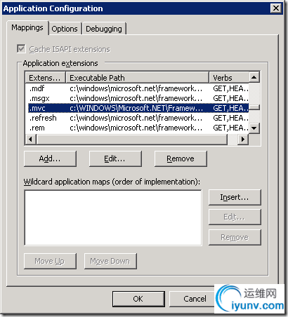

  For the rest of you, start by right clicking on the Virtual Application node (IIS6DemoWeb in this case) and select Properties. You should see the following dialog.
  Make sure you’re on the Virtual Directory tab and select Configuration. Note that you can also choose to make this change on the root website, in which case the tab you’re looking for is Home Directory not Virtual Directory.
  This will bring up the Application Configuration dialog which displays a list of ISAPI mappings. Scroll down to see if .mvc is in the list.
  In the screenshot, you can see that .mvc is in the list. If it is in the list on your machine, you can skip ahead to the next section. If it’s not in the list for you, let’s add it to the list. You’re going to need to know the path to the aspnet_isapi.dll first. On my machine, it is:
  c:\windows\microsoft.net\framework\v2.0.50727\aspnet_isapi.dll

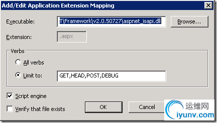

  It might differ on your machine. One easy way to find out is to find the .aspx extension in the list and double click it to bring up the mapping dialog.
  Now you can copy the path in the Executable text box to your clipboard. This is the path you’ll want to map .mvc to.
  Click Cancel to go back to the Application Configuration dialog and then click Add which will bring up an empty Add/Edit Application Extension Mapping dialog.
  Fill in the fields with the exact same values as you saw for .aspx, except the extension should be “.mvc” without the quotes. Click OK and you’re done with the mapping.

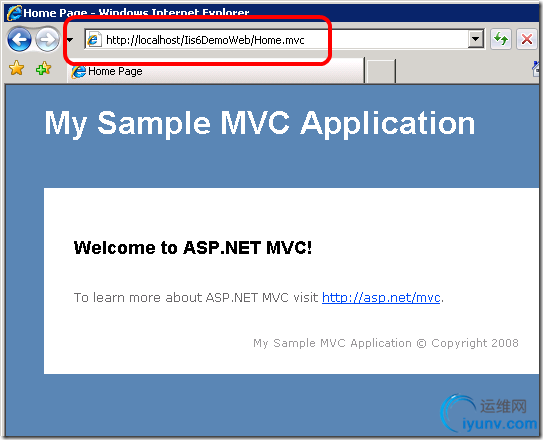

  Before we run the application, we need to update the default routes to look for the file extension we chose, whether it be .mvc or .aspx extension. Here is the RegisterRoutes method in my Global.asax.cs file using the .mvc extension. If you want to use the .aspx extension, just replace {controller}.mvc with {controller}.aspx.
public static void RegisterRoutes(RouteCollection routes) { routes.IgnoreRoute("{resource}.axd/{*pathInfo}"); routes.MapRoute( "Default", "{controller}.mvc/{action}/{id}", new { action = "Index", id = "" } ); routes.MapRoute( "Root", "", new { controller = "Home", action = "Index", id = "" } ); }  Note that because the second route, “Default”, has a literal extension as part of the URL segment, it cannot match a request for the application root. That’s why I have a third route named “Root” which can match requests for the application root.

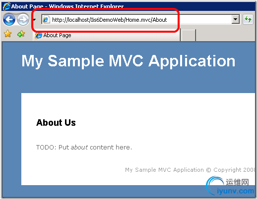

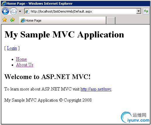

  Now, I can hit CTRL+F5 (or browse my website) and I should see the following home page.
  And about page.
  Notice that the URLs contain the .mvc extension.

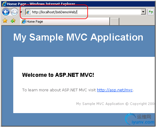

Uh oh, Houston! We have a problem
  Of course, you’re going to want to be able to navigate to the web root for your project. Notice what happens when you navigate to /Iis6DemoWeb.
  This is a bug in the Default.aspx.cs file included with our default template which I discovered as I was writing this walkthrough. We’ll fix it right away, but I can provide the fix here as it’s insanely easy.
  Note: If you received a File Not Found error when visiting the root, then you might not have Default.aspx mapped as a default document. Follow these steps to add Default.aspx as a default document.
  As I’ve written before, this file is necessary for IIS 6, IIS 7 Classic Mode, and pre SP1 Cassini, but not IIS 7 Integrated. So if you’re using Cassini with Visual Studio 2008 SP1 and deploying to IIS 7 Integrated, you can delete Default.aspx and its sub-files.
  In the meanwhile, the fix is to make the following change.
  Change:
HttpContext.Current.RewritePath(Request.ApplicationPath);  To
HttpContext.Current.RewritePath(Request.ApplicationPath, false);  If you created your website in the IIS root rather than a virtual application, you would never have noticed this issue. But in the virtual application, the URL to the stylesheet rendered contained the virtual application name, when it shouldn’t. Changing the second argument to false fixes this.

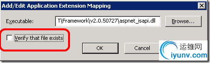

  This brings up the wildcard application mapping dialog. Enter the path to the aspnet_isapi.dll. You can follow the trick we mentioned earlier for getting this path.
  Don’t forget to uncheck the Verify that file exists checkbox! This is one of the most common mistakes people make.
