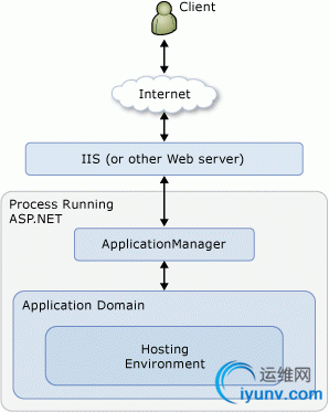

  When ASP.NET receives the first request for any resource in an application, a class named ApplicationManager creates an application domain. Application domains provide isolation between applications for global variables and allow each application to be unloaded separately. Within an application domain, an instance of the class named HostingEnvironment is created, which provides access to information about the application such as the name of the folder where the application is stored.
  The following diagram illustrates this relationship:
