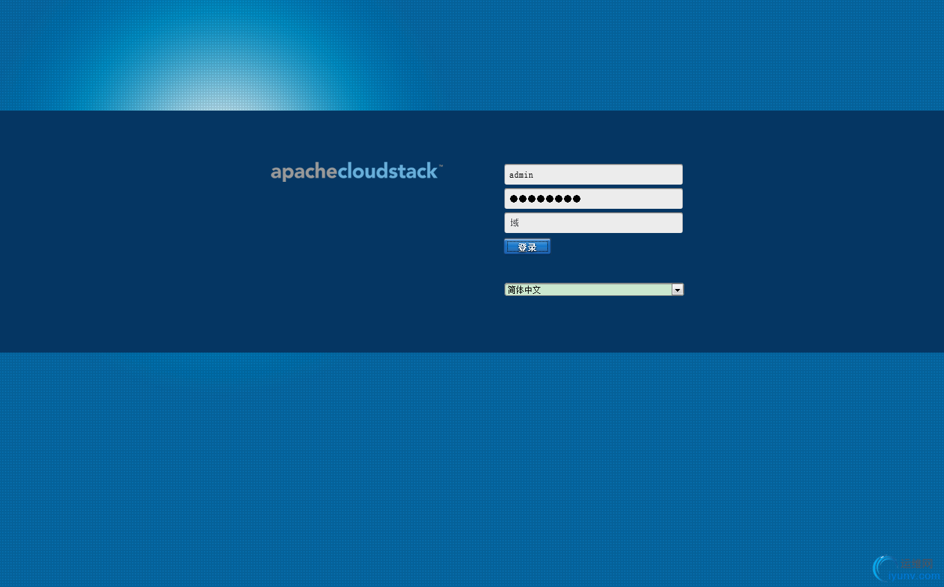

⑨、访问web
http://172.22.2.76:8080/client/
默认用户名和密码为admin, password
V4.4
V3.0
