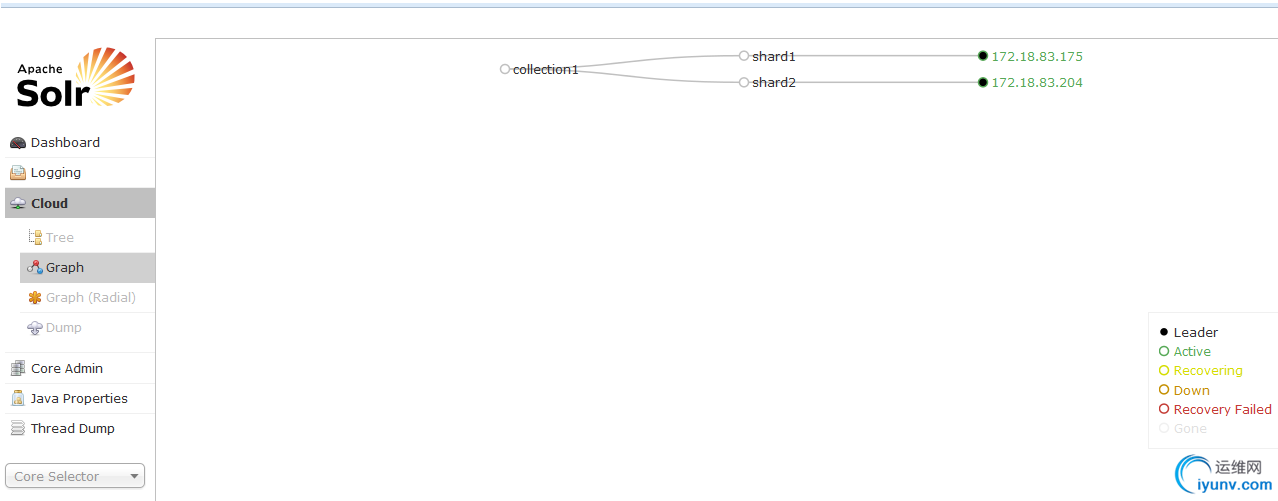

启动后登陆http://172.18.83.204:8080/solr/#/~cloud
