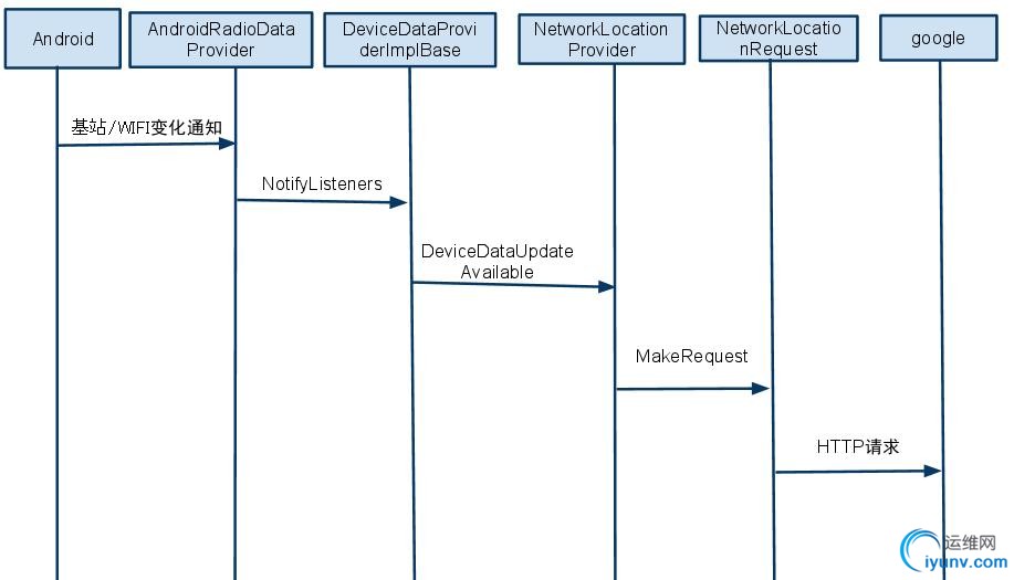

5.把变化(WIFI/基站)通知给相应的监听者。
1 AndroidWifiDataProvider和AndroidRadioDataProvider都是继承了DeviceDataProviderImplBase,DeviceDataProviderImplBase的主要功能就是管理所有Listeners。
3   static DeviceDataProvider *Register(ListenerInterface *listener) {
4     MutexLock mutex(&instance_mutex_);
5     if (!instance_) {
6       instance_ = new DeviceDataProvider();
7     }
8     assert(instance_);
9     instance_->Ref();
10     instance_->AddListener(listener);
11     return instance_;
12   }
13
14   static bool Unregister(ListenerInterface *listener) {
15     MutexLock mutex(&instance_mutex_);
16     if (!instance_->RemoveListener(listener)) {
17       return false;
18     }
19     if (instance_->Unref()) {
20       delete instance_;
21       instance_ = NULL;
22     }
23     return true;
24   }
25
6.谁在监听变化(WIFI/基站)
NetworkLocationProvider在监听变化(WIFI/基站):
1 radio_data_provider_ = RadioDataProvider::Register(this);
2   wifi_data_provider_ = WifiDataProvider::Register(this);
当有变化时,会调用函数DeviceDataUpdateAvailable:
代码
// DeviceDataProviderInterface::ListenerInterface implementation.
void NetworkLocationProvider::DeviceDataUpdateAvailable(
    RadioDataProvider *provider) {
  MutexLock lock(&data_mutex_);
  assert(provider == radio_data_provider_);
  is_radio_data_complete_ = radio_data_provider_->GetData(&radio_data_);
  DeviceDataUpdateAvailableImpl();
    WifiDataProvider *provider) {
  assert(provider == wifi_data_provider_);
  is_wifi_data_complete_ = wifi_data_provider_->GetData(&wifi_data_);
无论是WIFI还是基站变化,最后都会调用 DeviceDataUpdateAvailableImpl:
1 void NetworkLocationProvider::DeviceDataUpdateAvailableImpl() {
2   timestamp_ = GetCurrentTimeMillis();
4   // Signal to the worker thread that new data is available.
5   is_new_data_available_ = true;
6   thread_notification_event_.Signal();
7 }
这里面只是发了一个signal,通知另外一个线程去处理。

再来看MakeRequest的实现:
先从cache中查找位置:
1  const Position *cached_position =
2       position_cache_->FindPosition(radio_data_, wifi_data_);
3   data_mutex_.Unlock();
4   if (cached_position) {
5     assert(cached_position->IsGoodFix());
6     // Record the position and update its timestamp.
7     position_mutex_.Lock();
8     position_ = *cached_position;
9     position_.timestamp = timestamp_;
10     position_mutex_.Unlock();
11
12     // Let listeners know that we now have a position available.
13     UpdateListeners();
14     return true;
15   }
如果找不到,再做实际的请求
1   return request_->MakeRequest(access_token,
2                                radio_data_,
3                                wifi_data_,
4                                request_address_,
5                                address_language_,
6                                kBadLatLng,  // We don't have a position to pass

  1.WIFI和基站定位过程如下:
  2.NetworkLocationProvider和 NetworkLocationRequest各有一个线程来异步处理请求。
