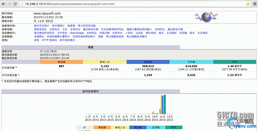

6、创建awstats日志报告静态html目录
mkdir -p /data/portalCms/web/www/static/awstats/
cp -R /usr/local/awstats/wwwroot/css /data/portalCms/web/www/static/awstats/
cp -R /usr/local/awstats/wwwroot/icon /data/portalCms/web/www/static/awstats/
7、手动生成html静态页面报告
[iyunv@portal-1 /]# /usr/local/awstats/tools/awstats_buildstaticpages.pl -update -config=www.ejoywifi.com -lang=cn -dir=/data/portalCms/web/www/static/awstats/wifiportal -awstatsprog=/usr/local/awstats/wwwroot/cgi-bin/awstats.pl
9
10
11
12
13
14
15
16
17
18
19
20
21
22
23
24
Launch update process : "/usr/local/awstats/wwwroot/cgi-bin/awstats.pl" -config=www.ejoywifi.com -update -configdir=
Build main page: "/usr/local/awstats/wwwroot/cgi-bin/awstats.pl" -config=www.ejoywifi.com -staticlinks -lang=cn -output
Build alldomains page: "/usr/local/awstats/wwwroot/cgi-bin/awstats.pl" -config=www.ejoywifi.com -staticlinks -lang=cn -output=alldomains
Build allhosts page: "/usr/local/awstats/wwwroot/cgi-bin/awstats.pl" -config=www.ejoywifi.com -staticlinks -lang=cn -output=allhosts
Build lasthosts page: "/usr/local/awstats/wwwroot/cgi-bin/awstats.pl" -config=www.ejoywifi.com -staticlinks -lang=cn -output=lasthosts
Build unknownip page: "/usr/local/awstats/wwwroot/cgi-bin/awstats.pl" -config=www.ejoywifi.com -staticlinks -lang=cn -output=unknownip
Build allrobots page: "/usr/local/awstats/wwwroot/cgi-bin/awstats.pl" -config=www.ejoywifi.com -staticlinks -lang=cn -output=allrobots
Build lastrobots page: "/usr/local/awstats/wwwroot/cgi-bin/awstats.pl" -config=www.ejoywifi.com -staticlinks -lang=cn -output=lastrobots
Build session page: "/usr/local/awstats/wwwroot/cgi-bin/awstats.pl" -config=www.ejoywifi.com -staticlinks -lang=cn -output=session
Build urldetail page: "/usr/local/awstats/wwwroot/cgi-bin/awstats.pl" -config=www.ejoywifi.com -staticlinks -lang=cn -output=urldetail
Build urlentry page: "/usr/local/awstats/wwwroot/cgi-bin/awstats.pl" -config=www.ejoywifi.com -staticlinks -lang=cn -output=urlentry
Build urlexit page: "/usr/local/awstats/wwwroot/cgi-bin/awstats.pl" -config=www.ejoywifi.com -staticlinks -lang=cn -output=urlexit
Build osdetail page: "/usr/local/awstats/wwwroot/cgi-bin/awstats.pl" -config=www.ejoywifi.com -staticlinks -lang=cn -output=osdetail
Build unknownos page: "/usr/local/awstats/wwwroot/cgi-bin/awstats.pl" -config=www.ejoywifi.com -staticlinks -lang=cn -output=unknownos
Build browserdetail page: "/usr/local/awstats/wwwroot/cgi-bin/awstats.pl" -config=www.ejoywifi.com -staticlinks -lang=cn -output=browserdetail
Build unknownbrowser page: "/usr/local/awstats/wwwroot/cgi-bin/awstats.pl" -config=www.ejoywifi.com -staticlinks -lang=cn -output=unknownbrowser
Build refererse page: "/usr/local/awstats/wwwroot/cgi-bin/awstats.pl" -config=www.ejoywifi.com -staticlinks -lang=cn -output=refererse
Build refererpages page: "/usr/local/awstats/wwwroot/cgi-bin/awstats.pl" -config=www.ejoywifi.com -staticlinks -lang=cn -output=refererpages
Build keyphrases page: "/usr/local/awstats/wwwroot/cgi-bin/awstats.pl" -config=www.ejoywifi.com -staticlinks -lang=cn -output=keyphrases
Build keywords page: "/usr/local/awstats/wwwroot/cgi-bin/awstats.pl" -config=www.ejoywifi.com -staticlinks -lang=cn -output=keywords
Build errors404 page: "/usr/local/awstats/wwwroot/cgi-bin/awstats.pl" -config=www.ejoywifi.com -staticlinks -lang=cn -output=errors404

9、访问静态页面
http://10.248.2.10:8080/static/awstats/awstats.www.ejoywifi.com.html
