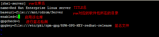

我们可以通过yum来查看,所以要配置yum
可以通过 yum grouplist查看
我的都装过了,如果你的没装,可以通过
yum groupadd 安装(如 yum groupadd "Legacy Software Development"

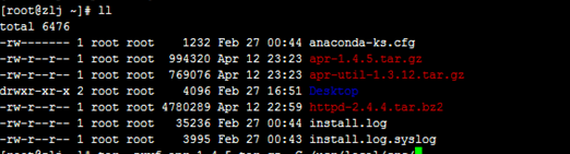

解压
[iyunv@zlj ~]# tar -zxvf apr-1.4.5.tar.gz -C /usr/local/src/
[iyunv@zlj ~]# tar -zxvf apr-util-1.3.12.tar.gz -C /usr/local/src/
[iyunv@zlj ~]# tar -jxvf httpd-2.4.4.tar.bz2 -C /usr/local/src/

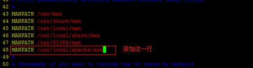

4)添加man手册
[iyunv@zlj ~]# vim /etc/man.config

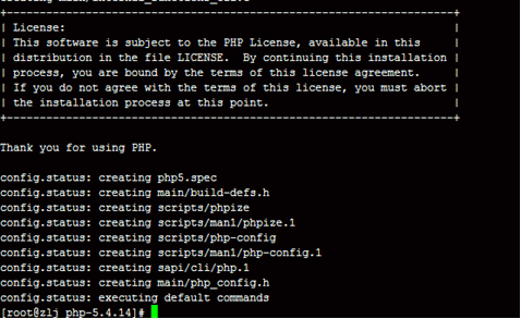

[iyunv@zlj php-5.4.14]# ./configure --prefix=/usr/local/php --with-apxs2=/usr/local/apache/bin/apxs  --with-mysql=/usr/local/mysql --with-mysqli=/usr/local/mysql/bin/mysql_config  --enable-mbstring   --enable-xml   --with-png-dir  --with-jpeg-dir  --with-zlib --enable-mbstring   --with-freetype-dir
生成配置文件成功

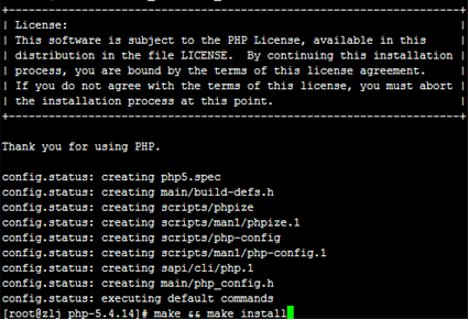

3root@zlj php-5.4.14]# make $$ make install
warning: pear/PEAR requires package "pear/Structures_Graph" (recommended version 1.0.4)
warning: pear/PEAR requires package "pear/XML_Util" (recommended version 1.2.1)
[PEAR] PEAR           - installed: 1.9.4
Wrote PEAR system config file at: /usr/local/php/etc/pear.conf
You may want to add: /usr/local/php/lib/php to your php.ini include_path
[PEAR] Structures_Graph- installed: 1.0.4
[PEAR] XML_Util       - installed: 1.2.1
/usr/local/src/php-5.4.14/build/shtool install -c ext/phar/phar.phar /usr/local/php/bin
ln -s -f /usr/local/php/bin/phar.phar /usr/local/php/bin/phar
Installing PDO headers:          /usr/local/php/include/php/ext/pdo/
它提示两条警告,不用管它

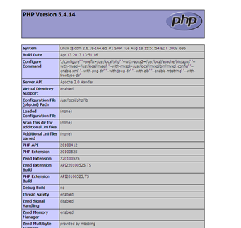

[iyunv@zlj htdocs]# mv index.html index.php
[iyunv@zlj htdocs]# vim index.php
<?php
phpinfo();
访问,看到下面的页面说明php正常

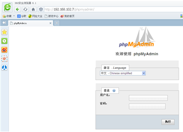

访问http://192.168.102.7/phpmyadmin/
填写mysql的用户名和密码 ,执行后
提示我:
配置文件现在需要一个短语密码。
缺少 mcrypt 扩展。请检查 PHP 配置。

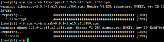

提示我们缺少libmcryptlibmhash
在官网http://www.rpmfind.net上下载
下载安装
[iyunv@zlj ~]# rpm -ivh libmcrypt-2.5.7-3.el5.remi.i386.rpm
[iyunv@zlj ~]# rpm -ivh libmcrypt-devel-2.5.7-3.el5.remi.i386.rpm #同样将libmcrypt的开发库装上
[iyunv@zlj ~]# rpm -ivh mhash-0.9.9-1.el5.rf.i386.rpm
[iyunv@zlj ~]# rpm -ivh mcrypt-2.6.4-3.el5.remi.i386.rpm

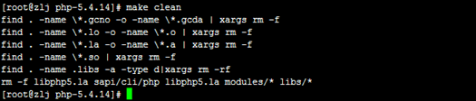

然后,重新编译安装php
清除配置文件
[iyunv@zlj php-5.4.14]# make clean
添上--with-mcrypt 再编译
[iyunv@zlj php-5.4.14]# ./configure --prefix=/usr/local/php --with-apxs2=/usr/local/apache/bin/apxs  --with-mysql=/usr/local/mysql --with-mysqli=/usr/local/mysql/bin/mysql_config  --enable-mbstring   --enable-xml   --with-png-dir  --with-jpeg-dir  --with-zlib --enable-mbstring   --with-freetype-dir  --with-mcrypt

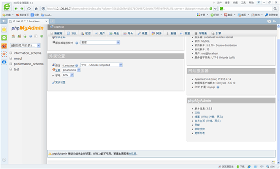

编译成功
再次登录看看
能够正常。
