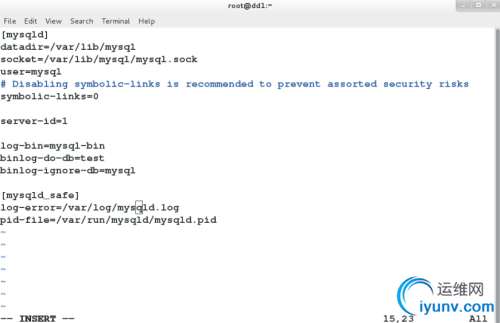

  vim /etc/my.cnf
  server-id=1
  log-bin=mysql-bin 启动二进制日志系统
  binlog-do-db=test 需要同步的数据库
  binlog-ignore-db=mysql 禁止同步的数据库

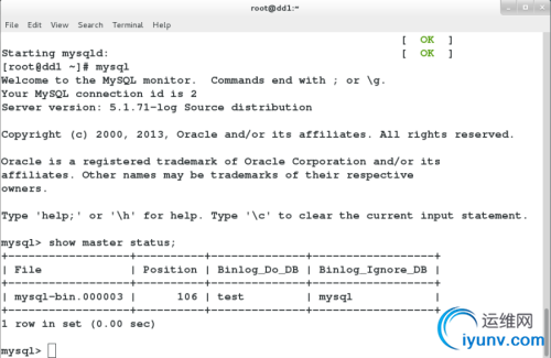

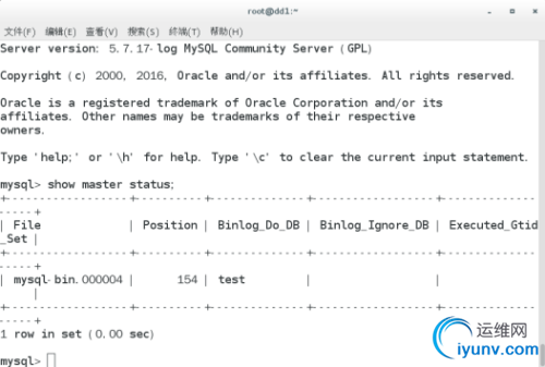

  /etc/init.d/mysqld start
  show master status

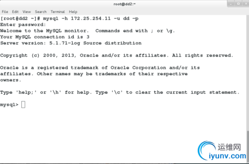

  dd2备:yum install mysql-server -y
  测试 看能不能远程登陆访问:mysql -h 172.25.254.11dd -p redhat

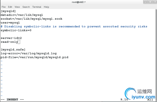

  vim /etc/my.cnf
  server-id=2
  read-only

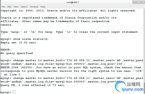

  mysql> change master tomaster_host='172.25.254.11', master_user='dd',
  master_password='redhat',master_log_file='mysql-bin.000003', master_log_pos=106;
  slave start

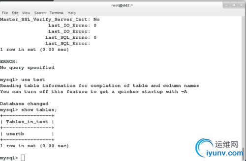

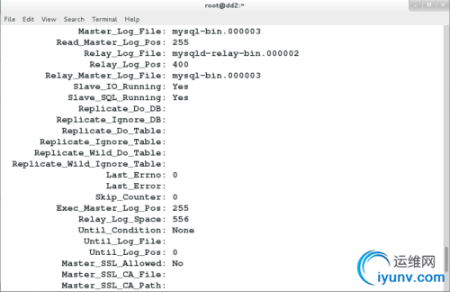

  show slave status\G
  Slave_IO_Running: Yes
  Slave_SQL_Running: Yes   如果都是 yes,表示从库的 I/O,Slave_SQL 线程都正确开启.表明数据库正在同步

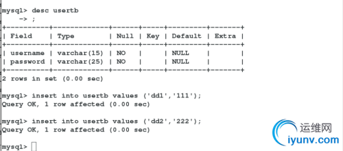

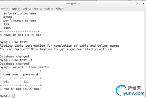

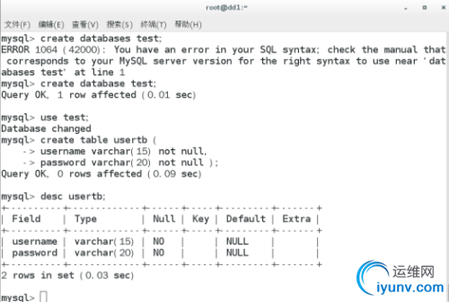

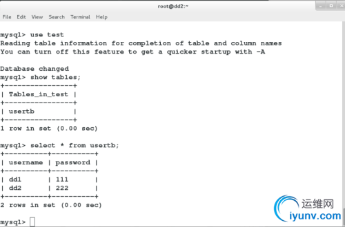

  测试:

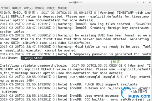

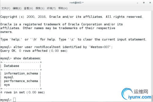

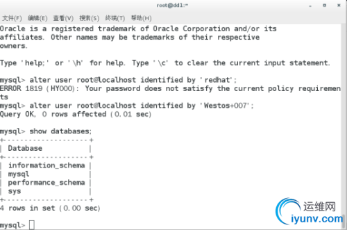

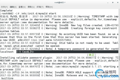

  注意:myslq密码在启动时初始化生成
  mysql -p
  alter userroot@localhost>

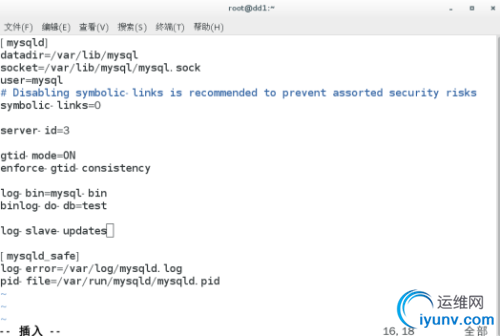

  dd1()
  vim /etc/my.cnf
  gtid-mode=ON
  enforce-gtid-consistency
  log-bin=mysql-bin
  binlog-do-db=test
  log-slave-updates  slave更新是否记录日志

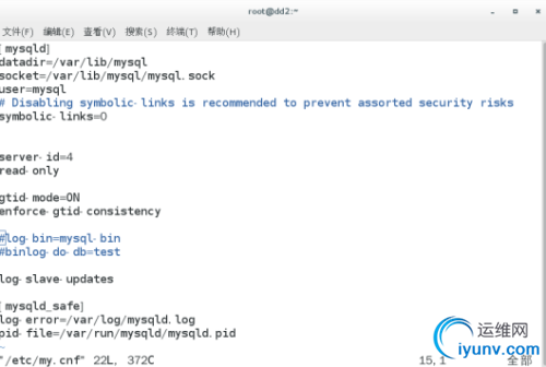

  dd2(备)
  vim /etc/my.cnf
  gtid-mode=ON
  #log-bin=mysql-bin
  #binlog-do-db=test
  log-slave-updates
  /etc/init.d/mysqld restart (两台同时)

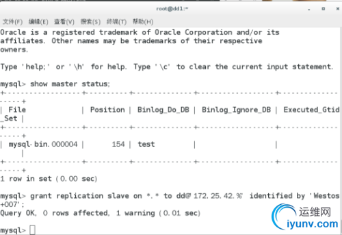

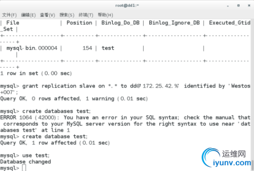

  dd1:mysql -p
  grant replicationslave on *.* to dd@'172.25.42.%'>

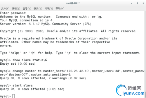

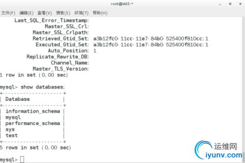

  change master tomaster_host='172.25.42.10',master_user='dd',master_password='Westos+007',master_auto_position=1;
  (注意和前一个主备设置的区别就不用手动添加要同步的日志自动定位因为在生产环境中备份服务器很可能不止一台这样每一分里面的同步日志是不同的无法定位所以gtid可以不用指定binlog和主mysql的读取指针定位)

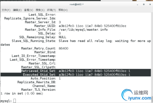

  start slave
  show slave status\G

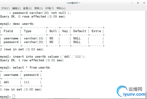

  同步测试:

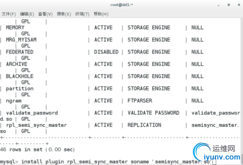

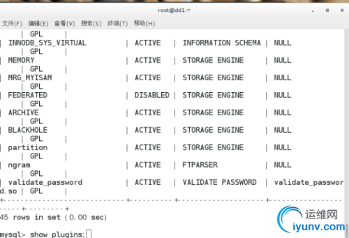

  主:show plugins
  install pluginrpl_semi_sync_master soname 'semisync_master.so'
  set globalrpl_semi_sync_master_enabled=1;
  show global statuslike '%semi%';
  show globalvariables like '%rpl_semi%';

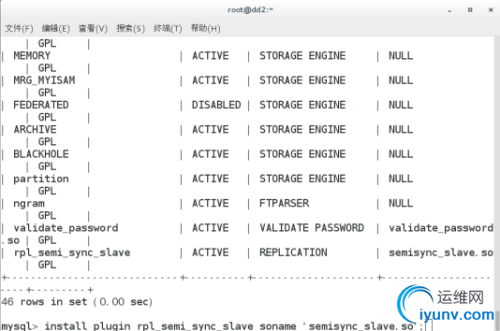

  从:show plugins
  install pluginrpl_semi_sync_master soname 'semisync_master.so';
  install pluginrpl_semi_sync_slave soname 'semisync_slave.so';

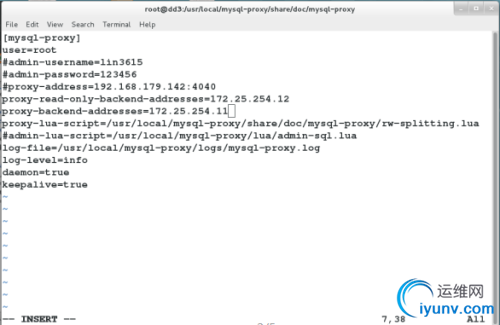

  vim mysql-proxy.conf
  [mysql-proxy]
  user=root
  #admin-username=lin3615
  #admin-password=123456
  #proxy-address=192.168.179.142:4040
  proxy-read-only-backend-addresses=172.25.0.4
  proxy-backend-addresses=172.25.0.3
  proxy-lua-script=/usr/local/mysql-proxy/share/doc/mysql-proxy/rw-splitting.lua
  #admin-lua-script=/usr/local/mysql-proxy/lua/admin-sql.lua
  log-file=/usr/local/mysql-proxy/logs/mysql-proxy.log
  log-level=info
  daemon=true
  keepalive=true

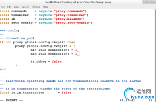

  cd /usr/local/mysql-proxy/share/dos
  vim rw-splitting.lua

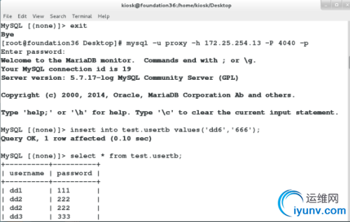

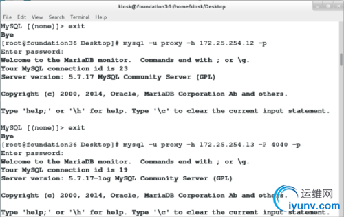

  dd1:
  grant all on *.* to proxy@'172.25.254.%'identified by'Westos+007';
  测试:
  通过代理访问数据库实现读写分离
