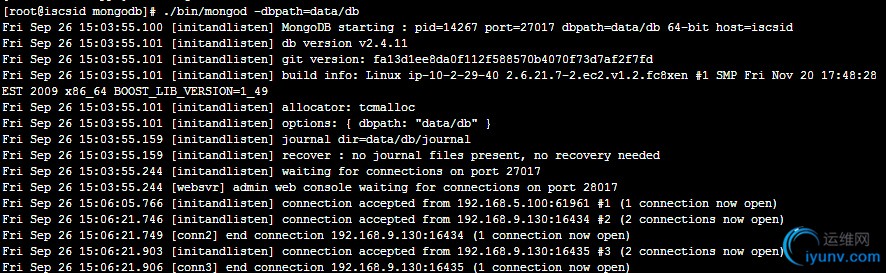

  1. Error: couldn't connect to server 127.0.0.1:27017 src/mongo/shell/mongo.js:91
  解决办法:执行以下语句
  [iyunv@vm13 mongodb]# ./bin/mongod -dbpath=data/db
