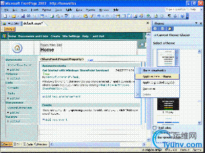

  • Open the Web site based on Windows SharePoint Services in FrontPage 2003 (select Open Site from the File menu, then type in the URL for your site; you will need to be able to supply the user name and password for the site).
  • Click Theme on the Format menu. The Theme task pane opens.
  • Click the Theme you want to start with, and then select Apply as default theme. Click Yes when asked if you want to apply the Theme to your entire site.

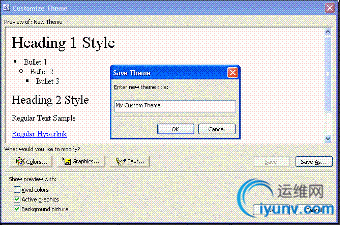

  • Click the Create new theme... link at the bottom of the Theme task pane. The Customize Theme dialog box opens.
  • Click the Save As button.
  • Type a name for your new Theme in the Save Theme dialog box, and then click OK.
  Now that you have saved your own Theme you can begin to customize it fully.

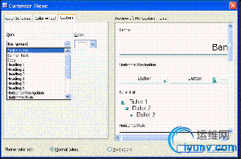

  One of the most common reasons for a custom Theme is to change default colors on key elements in a site.  Here is how to change many of the colors used in Themes:
  • Click the Colors button on the Customize Theme dialog box. The Customize Theme dialog opens to color options. You can change the colors of hyperlinks, horizontal rules, headings, body color, banner text, button text, and background colors here.  Simply select any of the elements listed, then change the color, and then click OK.

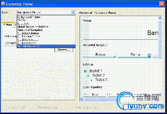

  FrontPage 2003 Themes include graphical elements like background images, button graphics, bullets, and more. To replace one of the graphical elements with your own, first import the graphics into your Web site. From there, specifying new graphics to use for key Theme components is easy:
  • Click the Graphics button on the Customize Theme dialog box. The Customize Theme dialog box opens to graphics options. Simply click the element you would like to replace, such as the background picture, banner image, and navigation buttons, and then specify the location of the new graphics in your Web site.  Click OK when you are finished.
  Tip: If you have created custom interactive buttons, you can use them as well in your Theme to serve as the buttons for link bars and navigation buttons in your site.
