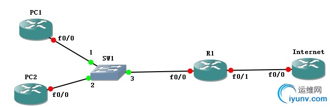

    实验一、策略路由当作ACL使用
    PC1配置:
    PC1#conf t
    PC1(config)#no ip routing
    PC1(config)#ip default-gateway 192.168.0.1
    PC1(config)#int fa0/0
    PC1(config-if)#ip add 192.168.0.101 255.255.255.0
    PC1(config-if)#no sh
    PC1(config-if)#exit
    PC2配置:
    PC2#conf t
    PC2(config)#no ip routing
    PC2(config)#ip default-gateway 192.168.0.1
    PC2(config)#int fa0/0
    PC2(config-if)#ip add 192.168.0.102 255.255.255.0
    PC2(config-if)#no sh
    PC2(config-if)#exit
    Internet配置:
    Internet#conf t
    Internet(config)#int fa0/0
    Internet(config-if)#ip add 202.100.100.100 255.255.255.0
    Internet(config-if)#no sh
    Internet(config-if)#exit
    Internet(config)#ip route 192.168.0.0 255.255.255.0202.100.100.1
    R1配置:
    R1#conf t
    R1(config)#int fa0/0
    R1(config-if)#ip add 192.168.0.1 255.255.255.0
    R1(config-if)#no sh
    R1(config-if)#exit
    R1(config)#int fa0/1
    R1(config-if)#ip add 202.100.100.1 255.255.255.0
    R1(config-if)#no sh
    R1(config-if)#exit
    R1(config)#access-list 1 permit host 192.168.0.101 //ACL标记流量
    R1(config)#route-map internet permit 10 //创建路由图
    R1(config-route-map)#match ip address 1 //设置匹配ACL流量
    R1(config-route-map)#set interface null0 //对符合的流量设置下一跳接口为null0,即掉弃
    R1(config-route-map)#exit
    R1(config-if)#ip policy route-map internet //将路由图应用到接口
    R1(config-if)#exit
    测试检查:
    PC1#ping 202.100.100.100
    Type escape sequence to abort.
    Sending 5, 100-byte ICMP Echos to 202.100.100.100,timeout is 2 seconds:
    Success rate is 0 percent (0/5)
    PC2#ping 202.100.100.100
    Success rate is 100 percent (5/5), round-trip min/avg/max= 20/40/108 ms
    R1#debug ip policy
    Policy routing debugging is on
    *Mar  100:15:57.371: IP: s=192.168.0.101 (FastEthernet0/0), d=202.100.100.100, len100, FIB policy match
    *Mar  100:15:57.371: IP: s=192.168.0.101 (FastEthernet0/0), d=202.100.100.100 (Null0),len 100, FIB policy routed(drop)
    *Mar  100:15:57.527: IP: s=192.168.0.102 (FastEthernet0/0), d=202.100.100.100, len100, FIB policy rejected(no match) - n                                            ormal forwarding
    *Mar  100:15:57.619: IP: s=192.168.0.102 (FastEthernet0/0), d=202.100.100.100, len100, FIB policy rejected(no match) - normal forwarding

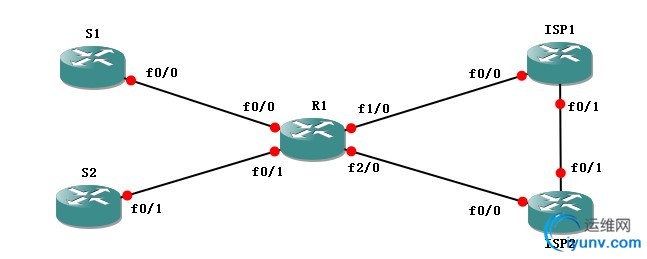

    实验二、基于源地址的路由策略
  • S1配置:
    S1#conf t
    S1(config)#int fa0/0
    S1(config-if)#ip add 192.168.11.11 255.255.255.0
    S1(config-if)#no sh
    S1(config-if)#exit
    S1(config)#router ospf 1
    S1(config-router)#net 192.168.11.0 0.0.0.255 area 0
    S1(config-router)#exit
    S2配置:
    S2#conf t
    S2(config)#int fa0/1
    S2(config-if)#ip add 192.168.22.22 255.255.255.0
    S2(config-if)#no sh
    S2(config-if)#exit
    S2(config)#router ospf 1
    S2(config-router)#net 192.168.22.0 0.0.0.255 area 0
    S2(config-router)#exit
    ISP1配置:
    ISP1#conf t
    ISP1(config)#int fa0/0
    ISP1(config-if)#ip add 100.100.100.100 255.255.255.0
    ISP1(config-if)#no sh
    ISP1(config-if)#exit
    ISP1(config)#int fa0/1
    ISP1(config-if)#ip add 12.12.12.1 255.255.255.0
    ISP1(config)#router ospf 1
    ISP1(config-router)#net 100.100.100.0 0.0.0.255 area 0
    ISP1(config-router)#net 12.12.12.0 0.0.0.255 area 0
    ISP1(config-router)#exit
    ISP2配置:
    ISP2#conf t
    ISP2(config)#int fa0/0
    ISP2(config-if)#ip add 200.200.200.200 255.255.255.0
    ISP2(config-if)#no sh
    ISP2(config-if)#exit
    ISP2(config)#int fa0/1
    ISP2(config-if)#ip add 12.12.12.2 255.255.255.0
    ISP2(config)#router ospf 1
    ISP2(config-router)#net 200.200.200.0 0.0.0.255 area 0
    ISP2(config-router)#net 12.12.12.0 0.0.0.255 area 0
    ISP2(config-router)#exit
    R1配置:
    R1#conf t
    R1(config-if)#ip add 192.168.11.1 255.255.255.0
    R1(config-if)#no sh
    R1(config-if)#exit
    R1(config-if)#ip add 192.168.22.1 255.255.255.0
    R1(config-if)#no sh
    R1(config-if)#exit
    R1(config)#int fa1/0
    R1(config-if)#ip add 100.100.100.1 255.255.255.0
    R1(config-if)#no sh
    R1(config-if)#exit
    R1(config)#int fa2/0
    R1(config-if)#ip add 200.200.200.1 255.255.255.0
    R1(config-if)#no sh
    R1(config-if)#exit
    R1(config)#router ospf 1
    R1(config-router)#net 0.0.0.0 255.255.255.255 area 0
    R1(config-router)#exit
    R1(config)#access-list 11 permit 192.168.11.0 0.0.0.255//ACL11标记192.168.11.0的流量
    R1(config)#access-list 22 permit 192.168.22.0 0.0.0.255//ACL22标记192.168.22.0的流量
    R1(config)#route-map s1 permit 10 //创建路由图s1,允许流量
    R1(config-route-map)#match ip address 11 //匹配ACL11的流量
    R1(config-route-map)#set ip next-hop 100.100.100.100//对匹配ACL11的流量直接转发到ISP1
    R1(config)#route-map s1 deny 20 //路由图S1拒绝其他所有流量
    R1(config)#route-map s2 permit 10//创建路由图S2,允许流量
    R1(config-route-map)#match ip address 22//匹配ACL22的流量
    R1(config-route-map)#set ip next-hop 200.200.200.200//ACL22的流量直接转发到ISP2
    R1(config)#route-map s2 deny 20//路由图S2拒绝其他所有流量
    R1(config-if)#ip policy route-map s1 //在接口下应用路由图S1
    R1(config-if)#exit
    R1(config-if)#ip policy route-map s2//在接口下应用路由图S2
    R1(config-if)#exit
    检查测试:
    S1#traceroute 200.200.200.200 //S1所有流量直接从ISP1走,不按照路由表路由
    Tracing the route to 200.200.200.200
      1 192.168.11.1 52msec 68 msec 24 msec
      2 100.100.100.10076 msec 68 msec 60 msec
      3 100.100.100.180 msec 52 msec 92 msec
      4 200.200.200.20092 msec 84 msec 120 msec
    S2#traceroute 100.100.100.100//S1所有流量直接从ISP2走,不按照路由表路由
    Tracing the route to 100.100.100.100
      1 192.168.22.1 64msec 40 msec 28 msec
      2 200.200.200.20064 msec 20 msec 36 msec
      3 200.200.200.1104 msec 64 msec 60 msec
      4 100.100.100.10076 msec 104 msec 128 msec
    R1#sh ip route
    Codes: C - connected, S - static, R - RIP, M - mobile, B- BGP
           D - EIGRP,EX - EIGRP external, O - OSPF, IA - OSPF inter area
           N1 - OSPFNSSA external type 1, N2 - OSPF NSSA external type 2
           E1 - OSPFexternal type 1, E2 - OSPF external type 2
           i - IS-IS,su - IS-IS summary, L1 - IS-IS level-1, L2 - IS-IS level-2
           ia - IS-ISinter area, * - candidate default, U - per-user static route
           o - ODR, P -periodic downloaded static route
    Gateway of last resort is not set
    C   200.200.200.0/24 is directly connected, FastEthernet2/0
         100.0.0.0/24is subnetted, 1 subnets
    C    100.100.100.0is directly connected, FastEthernet1/0
    C   192.168.11.0/24 is directly connected, FastEthernet0/0
    C   192.168.22.0/24 is directly connected, FastEthernet0/1
         12.0.0.0/24 issubnetted, 1 subnets
    O       12.12.12.0[110/11] via 200.200.200.200, 00:15:41, FastEthernet2/0
                      [110/11] via 100.100.100.100, 00:15:41, FastEthernet1/0
    R1#debug ip policy
    *Mar  100:27:52.919: IP: s=192.168.11.11 (FastEthernet0/0), d=200.200.200.200, len 28,FIB policy match
    *Mar  100:27:52.919: IP: s=192.168.11.11 (FastEthernet0/0), d=200.200.200.200,g=100.100.100.100, len 28, FIB policy routed
    *Mar  100:30:10.347: IP: s=192.168.22.22 (FastEthernet0/1), d=100.100.100.100, len 28,FIB policy match
    *Mar  100:30:10.347: IP: s=192.168.22.22 (FastEthernet0/1), d=100.100.100.100,g=200.200.200.200, len 28, FIB policy routed
    R1#sh route-map
    route-map s2, permit, sequence 10
      Match clauses:
        ip address(access-lists): 22
      Set clauses:
        ip next-hop200.200.200.200
      Policy routingmatches: 9 packets, 540 bytes
    route-map s2, deny, sequence 20
      Match clauses:
      Set clauses:
      Policy routingmatches: 0 packets, 0 bytes
    route-map s1, permit, sequence 10
      Match clauses:

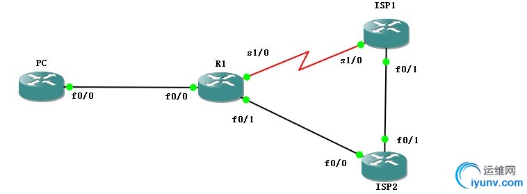

实验四、基于报文长度的策略路由
PC配置:
PC#conf t
PC(config)#no ip routing
PC(config)#ip default-gateway 192.168.0.1
PC(config)#int fa0/0
PC(config-if)#ip add 192.168.0.101 255.255.255.0
PC(config-if)#no sh
PC(config-if)#exit
ISP1配置:
ISP1#conf t
ISP1(config)#int s1/0
ISP1(config-router)#net 0.0.0.0 255.255.255.255 area 0
ISP2配置:
ISP2(config-router)#net 0.0.0.0 255.255.255.255 area 0
R1配置:
R1#conf t
R1(config-if)#no sh
R1(config-if)#exit
R1(config-if)#no sh
R1(config-if)#exit
R1(config)#int s1/0
R1(config-if)#no sh
R1(config-if)#exit
R1(config-if)#router ospf 1
R1(config)#route-map smallsize permit 10 //定义报文长度的路由图
R1(config-route-map)#match length 0 1000 //匹配报文长度为最小1 最大1000
R1(config-route-map)#set interface s1/0 //从符合条件的报文全部走s1/0接口
R1(config)#route-map smallsize permit 20//在路由图中设置其他报文的流量全部走fa0/1
R1(config-route-map)#set interface fa0/1
R1(config-if)#ip policy route-map smallsize
R1(config-if)#exit
检查测试:
PC#ping 12.12.12.1 size 1400
Sending 5, 1400-byte ICMP Echos to 12.12.12.1, timeout is2 seconds:
Success rate is 100 percent (5/5), round-trip min/avg/max= 92/108/128 ms
PC#ping 12.12.12.1 size 1000
Sending 5, 1000-byte ICMP Echos to 12.12.12.1, timeout is2 seconds:
Success rate is 100 percent (5/5), round-trip min/avg/max= 76/88/108 ms
R1#debug ip policy
*Mar  100:23:58.611: IP: s=192.168.0.101 (FastEthernet0/0), d=12.12.12.1, len 1400,FIB policy match
*Mar  100:23:58.611: IP: s=192.168.0.101 (FastEthernet0/0), d=12.12.12.1(FastEthernet0/1), len 1400, FIB policy routed
*Mar  100:23:58.767: IP: s=192.168.0.101 (FastEthernet0/0), d=12.12.12.1, len 1400,FIB policy match
*Mar  100:23:58.767: IP: s=192.168.0.101 (FastEthernet0/0), d=12.12.12.1(FastEthernet0/1), len 1400, FIB policy routed
*Mar  100:25:19.135: IP: s=192.168.0.101 (FastEthernet0/0), d=12.12.12.1 (Serial1/0),len 1000, FIB policy routed
*Mar  100:25:19.211: IP: s=192.168.0.101 (FastEthernet0/0), d=12.12.12.1, len 1000, FIBpolicy match

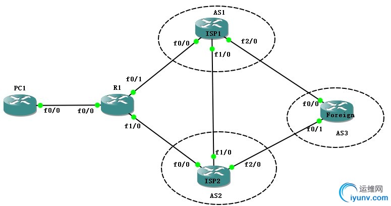

实验五、策略路由结合SLA与NAT,实现单路由双ISP基于目的地址负载冗余
IP SLA Internet Protocol Service-Level Agreement的缩写,意思是互联网协议服务等级协议。服务等级协议既可以用于关于网络服务供应商和客户间的一份合同,其中定义了服务类型、服务质量和客户付款等术语。IP SLA还是一个网络效能测量与诊断工具,它通过主动在多个端点之间或者多条路径之间发送封包来实现对网络效能的测量。IP SLA用于服务协议等级(SLA)监测、网络效能监测、网络服务评估、终端点到终端点的可用性监测、网络故障诊断、MPLS网络监测、VoIP网络监测
常见的场合就是:
    • 浮动静态路由下一跳检测。
    • HSRP出接口检测。
    • PBR策略路由下一跳检测。
  EEM是Cisco IOS的嵌入式事件管理器(Embeded Event Manager)的缩写,它提供了一种分布式的、可扩展的、可根据用户需求而灵活定制的,用于进行事件监控和故障恢复的机制。利用这种机制,当被监控的事件发生,或者是达到某个门限值时,EEM提供了进行消息报告以及采取相应动作的能力。一个完整的EEM的操作被称作 EEM Policy (EEM 策略),EEM Policy包括:定义监控的事件以及当被监控事件发生时所要执行的动作。EEM的整个架构由:EEM Server、Event Publisher(也称作:Event Detector)和Event Subscribers (EEM Policy)三个部分组成。其中,Event Publisher 负责监控和分析事件,并且在事件发生时,负责向EEM Server 通告事件的发生。而后,EEM Server触发EEM Policy 基于当前的系统状态以及所配置的具体动作,例如:执行IOS的命令行、发送SNMP Trap、发起主备引擎切换、产生Syslog信息等等,实施相应的恢复措施。其中Event Detector是核心和基础,正是由于Event Detector能够灵活地监控各种事件,才使得EEM具有强大的功能。作为事件使用者的EEM Policy可以通过两种方式来进行定义:一种是编写Applet小程序,这种基于Applet编写的EEM Policy可以通过命令行方式来配置,适合于比较简单的EEM操作;而另外一种是通过编写TCL脚本程序来实现,这种方式更适合于需要复杂逻辑判断、功能需求比较灵活的EEM操作。
PC1配置:
PC1#conf t

R1(config)#ip access-list extended isp1//用ACL抓取去往ISP1的目的地址
R1(config-ext-nacl)#permit ip any 100.100.100.0 0.0.0.255
R1(config-ext-nacl)#permit ip any 1.1.1.0 0.0.0.255
R1(config-ext-nacl)#permit ip any 11.11.11.0 0.0.0.255
R1(config-ext-nacl)#permit ip any 111.111.111.0 0.0.0.255
R1(config-ext-nacl)#permit ip any 12.12.12.0 0.0.0.255
R1(config-ext-nacl)#permit ip any 13.13.13.0 0.0.0.255
R1(config-ext-nacl)#exit
R1(config)#ip access-list extended isp2 //用ACL抓取去往ISP2的目的地址
R1(config-ext-nacl)#permit ip any 200.200.200.0 0.0.0.255
R1(config-ext-nacl)#permit ip any 2.2.2.0 0.0.0.255
R1(config-ext-nacl)#permit ip any 22.22.22.0 0.0.0.255
R1(config-ext-nacl)#permit ip any 222.222.222.0 0.0.0.255
R1(config-ext-nacl)#permit ip any 23.23.23.0 0.0.0.255
R1(config)#ip access-list extended foreign //抓取非ISP1和ISP2的网络
R1(config-ext-nacl)#permit ip any any
R1(config)#ip sla 1 //创建SLA 任务1
R1(config-ip-sla)#icmp-echo 100.100.100.1 source-ip100.100.100.100//设置任务SLA1,用100.100.100.100去ping ISP1
R1(config-ip-sla-echo)#timeout 1200//每个包发出去多长时间还没收到就代表失败,单位毫秒
R1(config-ip-sla-echo)#frequency 5//设置任务SLA1每隔5s执行一次
R1(config-ip-sla-echo)#exit
R1(config)#ip sla schedule 1 life forever start-time now//设置任务SLA1马上执行
R1(config)#track 1 rtr 1 reachability//使用track 追踪SLA1,检查线路的可达性
R1(config-track)#exit
R1(config)#ip sla 2//创建SLA 任务2
R1(config-ip-sla)#icmp-echo 200.200.200.2 source-ip200.200.200.200//设置任务SLA2,用200.200.200.200去ping ISP2
R1(config-ip-sla-echo)#frequency 5//设置任务SLA2每隔5s执行一次
R1(config)#ip sla schedule 2 life forever start-time now//设置任务SLA2马上执行
R1(config)#track 2 rtr 2 reachability//使用track追踪SLA2,检查线路的可达性
R1(config)#route-map isp-working permit 10//创建路由图isp-working,用于不同线路分配流量
R1(config-route-map)#match ip address isp1//匹配去往isp1网段的流量
R1(config-route-map)#set ip next verify-availability100.100.100.1 1 track 1//追踪ISP1的可达性,如果可达,则设置匹配的流量走ISP1线路,否则这条语句不生效,并执行下一语句。
R1(config-route-map)#set ip next verify-availability200.200.200.2 2 track 2//追踪ISP2的可达性,如果可达,则设置匹配的流量走ISP2线路,否则这条语句不生效,并执行下一语句。
R1(config)#route-map isp-working permit 20
R1(config-route-map)#match ip address isp2 //匹配去往ISP2网段的流量
R1(config-route-map)#set ip next verify-availability200.200.200.2 1 track 2//追踪ISP2的可达性,如果可达,则设置匹配的流量走ISP2线路,否则这条语句不生效,并执行下一语句。
R1(config-route-map)#set ip next verify-availability100.100.100.1 2 track 1//追踪ISP1的可达性,如果可达,则设置匹配的流量走ISP1线路,否则这条语句不生效,并执行下一语句。
R1(config)#route-map isp-working permit 30//处理其他既不是去往ISP1也不是去往ISP2的流量。
R1(config-route-map)#match ip address foreign
R1(config)#route-map nat-isp1 permit 110//创建NAT条件路由图nat-isp1,匹配当ISP1线路正常,去往ISP1网段且从fa0/1出去的流量
R1(config-route-map)#match interface fa0/1
R1(config)#route-map nat-isp11 permit 110//创建NAT条件路由图nat-isp11,匹配当ISP1线路断掉,去往ISP1网段且从fa1/0出去的流量
R1(config-route-map)#match interface fa1/0
R1(config)#route-map nat-isp2 permit 110//创建NAT条件路由图nat-isp2,匹配当ISP2线路正常,去往ISP2网段且从fa1/0出去的流量
R1(config)#route-map nat-isp22 permit 110//创建NAT条件路由图nat-isp22,匹配当ISP2线路断掉,去往ISP2网段且从fa0/1出去的流量
R1(config)#route-map nat-foreign1 permit 220//创建NAT条件路由图nat-foreign1,匹配选择ISP1为出口,且既不是ISP1也不是ISP2的流量
R1(config)#route-map nat-foreign2 permit 220//创建NAT条件路由图nat-foreign2,匹配选择ISP2为出口,且既不是ISP1也不是ISP2的流量
R1(config)#ip nat inside source route-map nat-isp1interface fa0/1 overload//当ISP1线路正常,且去往ISP1网段时就转换
R1(config)#ip nat inside source route-map nat-isp11interface fa1/0 overload//当ISP1线路断掉,而ISP2线路正常,且又是去往ISP1网段时就转换,备用
R1(config)#ip nat inside source route-map nat-isp2interface fa1/0 overload//当ISP2线路正常,且去往ISP2网段时就转换
R1(config)#ip nat inside source route-map nat-isp22interface fa0/1 overload////当ISP2线路断掉,而ISP1线路正常,且又是去往ISP2网段时就转换,备用
R1(config)#ip nat inside source route-map nat-foreign1interface fa0/1 overload//如果ISP1线路正常,其他非去往ISP1或ISP2的流量,且从fa0/1出去的流量就转换
R1(config)#ip nat inside source route-map nat-foreign2interface fa1/0 overload/如果ISP1线路线路断掉,而ISP2线路正常,此时其他既不是去往ISP1也不是去往ISP2网段,且从fa1/0出去的流量就转换
R1(config-if)#ip policy route-map isp-working//将策略路由应用到接口fa0/0
R1(config-if)#exit
R1(config)#event manager applet ISP1-NAT-Status//创建EEM事件管理器ISP1-NAT-Status,用于清空NAT转换表,避免线路切换时导致NAT转换不能更新
R1(config-applet)#event track 1 state any //检测追踪ISP1线路的状态是否变化,如果变化执行下一步,否则不执行
R1(config-applet)#action 1 cli command "enable"//执行Cisoc IOS命令enable进入特权模式
R1(config-applet)#action 2 cli command "clear ip ,nattranslation *"//再执行clear ip nat translation *清除NAT转换表
R1(config-applet)#action 3 syslog msg "WAN failover,cleared NAT"//将事件写入日志记录
R1(config-applet)#exit
R1(config)#event manager applet ISP2-NAT-Status//创建EEM事件管理器ISP2-NAT-Status,用于清空NAT转换表,避免线路切换时导致NAT不能更新
R1(config-applet)#event track 2 state any//检测追踪ISP2线路的状态是否变化,如果变化执行下一步,否则不执行
R1(config-applet)#action 1 cli command "enable" //执行Cisoc IOS命令enable进入特权模式
R1(config-applet)#action 2 cli command "clear ip nattranslation *"//再执行clear ip nat translation *清除NAT转换表
检查测试:
PC1#ping 1.1.1.1 r 500 //用PC1去ping 1.1.1.1,然后关闭ISP1的fa0/0接口,线路自动切换
Sending 500, 100-byte ICMP Echos to 1.1.1.1, timeout is 2seconds:
Success rate is 99 percent (495/500), round-tripmin/avg/max = 36/45/132 m
PC1#ping 2.2.2.2  r500 //用PC1去ping 2.2.2.2,然后关闭ISP2的fa0/0接口,线路自动切换
Sending 500, 100-byte ICMP Echos to 2.2.2.2, timeout is 2seconds:
Success rate is 99 percent (495/500), round-tripmin/avg/max = 28/54/148 ms
PC1#ping 3.3.3.3  r500//用PC1去ping 3.3.3.3,然后关闭ISP1的fa0/0接口,线路自动切换
Sending 500, 100-byte ICMP Echos to 3.3.3.3, timeout is 2seconds:
Success rate is 99 percent (495/500), round-tripmin/avg/max = 24/39/148 ms
R1#debug ip nat //R1调试NAT
R1#debug ip policy //R1调试策略路由
Mar  1 00:03:20.059: IP: s=192.168.0.100(FastEthernet0/0), d=1.1.1.1, len 100, FIB policy match
*Mar  1 00:03:20.063: IP: s=192.168.0.100(FastEthernet0/0), d=1.1.1.1, g=100.100.100.1, len 100, FIB policy routed
*Mar  1 00:03:20.067: NAT*: ICMP id=0->1
*Mar  1 00:03:20.067: NAT*:s=192.168.0.100->100.100.100.100, d=1.1.1.1 [4]
*Mar  1 00:03:20.587: %TRACKING-5-STATE: 1 rtr 1reachability Up->Down
*Mar  1 00:03:22.059: IP: s=192.168.0.100(FastEthernet0/0), d=1.1.1.1, len 100, FIB policy match
*Mar  1 00:03:22.063: IP: s=192.168.0.100(FastEthernet0/0), d=1.1.1.1, g=200.200.200.2, len 100, FIB policy routed
*Mar  1 00:03:22.071: NAT*:s=192.168.0.100->200.200.200.200, d=1.1.1.1 [5]
*Mar  1 00:11:44.787: IP: s=192.168.0.100(FastEthernet0/0), d=2.2.2.2, len 100, FIB policy match
*Mar  1 00:11:44.791: IP: s=192.168.0.100(FastEthernet0/0), d=2.2.2.2, g=200.200.200.2, len 100, FIB policy routed
*Mar  1 00:11:44.799: NAT*:s=192.168.0.100->200.200.200.200, d=2.2.2.2 [1029]
*Mar  1 00:11:45.667: %TRACKING-5-STATE: 2 rtr 2reachability Up->Down
*Mar  1 00:11:46.759: IP: s=192.168.0.100(FastEthernet0/0), d=2.2.2.2, len 100, FIB policy match
*Mar  1 00:11:46.763: IP: s=192.168.0.100(FastEthernet0/0), d=2.2.2.2, g=100.100.100.1, len 100, FIB policy routed
*Mar  1 00:11:46.771: NAT*:s=192.168.0.100->100.100.100.100, d=2.2.2.2 [1030]
*Mar  1 00:20:00.607: IP: s=192.168.0.100(FastEthernet0/0), d=3.3.3.3, len 100, FIB policy match
*Mar  1 00:20:00.611: IP: s=192.168.0.100(FastEthernet0/0), d=3.3.3.3, g=100.100.100.1, len 100, FIB policy routed
*Mar  1 00:20:00.615: NAT*:s=192.168.0.100->100.100.100.100, d=3.3.3.3 [1530]
*Mar  1 00:20:00.675: %TRACKING-5-STATE: 1 rtr 1reachability Up->Down
*Mar  1 00:20:02.591: IP: s=192.168.0.100(FastEthernet0/0), d=3.3.3.3, len 100, FIB policy match
*Mar  1 00:20:02.591: IP: s=192.168.0.100(FastEthernet0/0), d=3.3.3.3, g=200.200.200.2, len 100, FIB policy routed
*Mar  1 00:20:02.599: NAT*:s=192.168.0.100->200.200.200.200, d=3.3.3.3 [1531]

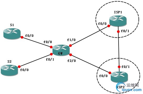

实验六、策略路由结合SLA与NAT,实现单路由双ISP基于源地址负载冗余
S1配置:
S1#conf t
S1(config-if)#ip add 192.168.1.100 255.255.255.0
S1(config-if)#no sh
S1(config-if)#exit
S1(config)#ip route 0.0.0.0 0.0.0.0 192.168.1.1
S2配置:
S2#conf t
S2(config)#int fa0/0
S2(config-if)#ip add 172.168.2.200 255.255.255.0
S2(config-if)#no sh
S2(config-if)#exit
S2(config)#ip route 0.0.0.0 0.0.0.0 172.168.200.1
ISP1配置:
ISP1#conf t
ISP1(config-if)#ip add 100.100.100.1 255.255.255.0
ISP1(config)#int lo 1
ISP1(config-if)#ip add 1.1.1.1 255.255.255.0
ISP1(config)#int lo 2
ISP1(config-if)#ip add 11.11.11.11 255.255.255.0
ISP1(config)#router bgp 1
ISP1(config-router)#bgp router-id 1.1.1.1
ISP1(config-router)#network 1.1.1.0 mask 255.255.255.0
ISP1(config-router)#network 11.11.11.0 mask 255.255.255.0
ISP1(config-router)#network 100.100.100.0 mask255.255.255.0
ISP1(config-router)#network 12.12.12.0 mask 255.255.255.0
ISP1(config-router)#neighbor 12.12.12.2 remote-as 2
ISP2配置:
ISP2#conf t
ISP2(config-if)#ip add 200.200.200.2 255.255.255.0
ISP2(config)#int lo 1
ISP2(config-if)#ip add 2.2.2.2 255.255.255.0
ISP2(config)#int lo 2
ISP2(config-if)#ip add 22.22.22.22 255.255.255.0
ISP2(config)#router bgp 2
ISP2(config-router)#bgp router-id 2.2.2.2
ISP2(config-router)#network 2.2.2.0 mask 255.255.255.0
ISP2(config-router)#network 22.22.22.0 mask 255.255.255.0
ISP2(config-router)#network 200.200.200.0 mask255.255.255.0
ISP2(config-router)#network 12.12.12.0 mask 255.255.255.0
ISP2(config-router)#neighbor 12.12.12.1 remote-as 1
GW配置:
GW#conf t
GW(config)#int fa0/0
GW(config-if)#ip add 192.168.1.1 255.255.255.0
GW(config-if)#ip nat inside
GW(config-if)#no sh
GW(config-if)#exit
GW(config)#int fa0/1
GW(config-if)#ip add 172.168.2.1 255.255.255.0
GW(config-if)#no sh
GW(config-if)#exit
GW(config)#int fa1/0
GW(config-if)#ip add 100.100.100.100 255.255.255.0
GW(config-if)#ip nat outside
GW(config-if)#no sh
GW(config-if)#exit
GW(config)#int fa2/0
GW(config-if)#ip add 200.200.200.200 255.255.255.0
GW(config-if)#no sh
GW(config-if)#exit
GW(config)#ip access-list standard s1
GW(config-std-nacl)#permit 192.168.1.0 0.0.0.255
GW(config-std-nacl)#exit
GW(config)#ip access-list standard s2
GW(config-std-nacl)#permit 172.168.2.0 0.0.0.255
GW(config)#ip sla 1
GW(config-ip-sla)#icmp-echo 100.100.100.1 source-ip100.100.100.100
GW(config-ip-sla-echo)#timeout 300
GW(config-ip-sla-echo)#frequency 5
GW(config-ip-sla-echo)#exit
GW(config)#ip sla 2
GW(config-ip-sla)#icmp-echo 200.200.200.2 source-ip200.200.200.200
GW(config)#track 1 rtr 1 reachability
GW(config-track)#exit
GW(config)#track 2 rtr 2 reachability
GW(config)#ip sla schedule 1 life forever start-time now
GW(config)#ip sla schedule 2 life forever start-time now
GW(config)#route-map s1-s2-road permit 10
GW(config-route-map)#match ip address s1
GW(config-route-map)#set ip next-hop verify-availability100.100.100.1 1 track 1
GW(config-route-map)#set ip next-hop verify-availability200.200.200.2 2 track 2
GW(config-route-map)#exit
GW(config)#route-map s1-s2-road permit 20
GW(config-route-map)#match ip address s2
GW(config-route-map)#set ip next-hop verify-availability200.200.200.2 1 track 2
GW(config-route-map)#set ip next-hop verify-availability100.100.100.1 2 track 1
GW(config-if)#ip policy route-map s1-s2-road
GW(config-if)#exit
GW(config-if)#exit
GW(config)#route-map s1-nat1 permit 10
GW(config-route-map)#match interface fa1/0
GW(config)#route-map s1-nat2 permit 10
GW(config-route-map)#match interface fa2/0
GW(config)#route-map s2-nat1 permit 10
GW(config)#route-map s2-nat2 permit 10
GW(config)#ip nat inside source route-map s1-nat1interface fa1/0 overload
GW(config)#ip nat inside source route-map s1-nat2interface fa2/0 overload
GW(config)#ip nat inside source route-map s2-nat1interface fa2/0 overload
GW(config)#ip nat inside source route-map s2-nat2interface fa1/0 overload
GW(config)#event manager applet s1-nat-status
GW(config-applet)#event track 1 state any
GW(config-applet)#action 1 cli command "enable"
GW(config-applet)#action 2 cli command "clear ip nattranslation *"
GW(config-applet)#exit
GW(config)#event manager applet s2-nat-status
GW(config-applet)#event track 2 state any
检查测试:
S1#ping 1.1.1.1  r600 //S1去ping1.1.1.1,在ping的期间将ISP1的fa0/0接口关闭,线路自动进行切换ISP2
Sending 600, 100-byte ICMP Echos to 1.1.1.1, timeout is 2seconds:
Success rate is 99 percent (595/600), round-tripmin/avg/max = 36/66/188 ms
S2#ping 2.2.2.2 r 600//S2去ping 2.2.2.2,在ping的期间将ISP2的fa0/0接口关闭,线路进行切换到ISP1
Sending 600, 100-byte ICMP Echos to 2.2.2.2, timeout is 2seconds:
Success rate is 99 percent (596/600), round-tripmin/avg/max = 40/67/140 ms
GW#debug ip nat
IP NAT debugging is on
GW#debug ip policy
*Mar  1 00:04:30.883: NAT*:s=192.168.1.100->100.100.100.100, d=1.1.1.1 [720]
*Mar  1 00:04:32.875: IP: s=192.168.1.100(FastEthernet0/0), d=1.1.1.1, len 100, FIB policy match
*Mar  1 00:04:32.879: IP: s=192.168.1.100(FastEthernet0/0), d=1.1.1.1, g=100.100.100.1, len 100, FIB policy routed
*Mar  1 00:04:32.883: NAT*:s=192.168.1.100->100.100.100.100, d=1.1.1.1 [721]
*Mar  1 00:04:33.447: %TRACKING-5-STATE: 1 rtr 1reachability Up->Down
*Mar  1 00:04:34.899: IP: s=192.168.1.100(FastEthernet0/0), d=1.1.1.1, len 100, FIB policy match
*Mar  1 00:04:34.903: IP: s=192.168.1.100(FastEthernet0/0), d=1.1.1.1, g=200.200.200.2, len 100, FIB policy routed
*Mar  1 00:04:34.907: NAT*:s=192.168.1.100->200.200.200.200, d=1.1.1.1 [722]
*Mar  1 00:04:34.999: NAT*: s=1.1.1.1,d=200.200.200.200->192.168.1.100 [722]
*Mar 1 00:25:25.243: NAT*: s=172.168.2.200->200.200.200.200, d=2.2.2.2[686]
*Mar 1 00:25:27.239: IP: s=172.168.2.200 (FastEthernet0/1), d=2.2.2.2, len100, FIB policy match
*Mar 1 00:25:27.243: IP: s=172.168.2.200 (FastEthernet0/1), d=2.2.2.2,g=200.200.200.2, len 100, FIB policy routed
*Mar 1 00:25:27.247: NAT*: s=172.168.2.200->200.200.200.200, d=2.2.2.2[687]
*Mar 1 00:25:28.579: %TRACKING-5-STATE: 2 rtr 2 reachability Up->Down
*Mar 1 00:25:29.227: IP: s=172.168.2.200 (FastEthernet0/1), d=2.2.2.2, len100, FIB policy match
*Mar 1 00:25:29.231: IP: s=172.168.2.200 (FastEthernet0/1), d=2.2.2.2,g=100.100.100.1, len 100, FIB policy routed
*Mar 1 00:25:29.239: NAT*: s=172.168.2.200->100.100.100.100, d=2.2.2.2[688]
