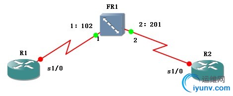

实验十四、帧中继的流量整形
R1配置:
R1#conf t
R1(config)#int s1/0
R1(config-if)#clock rate 64000
R1(config-if)#ip add 192.168.12.1255.255.255.0
R1(config-if)#encapsulation frame-relay
R1(config-if)#frame-relay map ip 192.168.12.2102
R1(config-if)#frame-relay interface-dlci 102
R1(config-fr-dlci)#class DLCI102
R1(config-fr-dlci)#exit
R1(config-if)#no sh
R1(config-if)#exit
R1(config)#policy-map SHAPE
R1(config-pmap)#class>
R1(config-pmap-c)#shape average 64000
R1(config-pmap-c)#exit
R1(config-pmap)#exit
R1(config)#map-class frame-relay DLCI102
R1(config-map-class)#service-policy outputSHAPE
R1(config-map-class)#exit
R2配置:
R2#conf t
R2(config)#int s1/0
R2(config-if)#clock rate 64000
R2(config-if)#encapsulation frame-relay
R2(config-if)#frame-relay map ip 192.168.12.1201
R2(config-if)#ip add 192.168.12.2255.255.255.0
R2(config-if)#no sh
R2(config-if)#exit
检查测试配置
R1# ping 192.168.12.2 rep 20>
Type escape sequence to abort.
Sending 20, 2000-byte ICMP Echos to 192.168.12.2, timeoutis 2 seconds:
Success rate is 100 percent (20/20), round-tripmin/avg/max = 188/358/496 ms
Sending 20, 6000-byte ICMP Echos to 192.168.12.2, timeoutis 2 seconds:
Success rate is 55 percent (11/20), round-tripmin/avg/max = 1304/1771/1996 ms
R1#sh policy-map int s1/0
 Serial1/0: DLCI102 -
  Service-policyoutput: SHAPE
    Class-map:class-default (match-any)
      110 packets,123040 bytes
      5 minute offered rate 8000 bps, drop rate 0bps
      Match: any
      TrafficShaping
          Target/Average   Byte   Sustain  Excess    Interval  Increment
            Rate           Limit  bits/int bits/int  (ms)      (bytes)
            64000/64000     2000  8000      8000      125      1000
        Adapt  Queue    Packets   Bytes     Packets  Bytes     Shaping
        ActiveDepth                        Delayed   Delayed   Active
        -      0        110       123040    60       61840     no

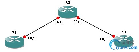

 实验十五、拥塞避免之RSVP(资源保留协议)
R1配置:
R1#conf t
Enter configuration commands, one per line.  End with CNTL/Z.
R1(config)#int lo 1
R1(config-if)#ip add 1.1.1.1 255.255.255.0
R1(config-if)#exit
R1(config)#int fa0/0
R1(config-if)#ip add 192.168.12.1 255.255.255.0
R1(config-if)#ip rsvp bandwidth 20 8//配置总的保留带宽(total-BW)per-flow的最大保留带宽(per-flow-BW).单位:kbps
R1(config-if)#no sh
R1(config-if)#exit
R1(config)#router rip
R1(config-router)#version 2
R1(config-router)#no auto-summary
R1(config-router)#net 1.1.1.0
R1(config-router)#net 192.168.12.0
R1(config-router)#exit
R2配置:
R2#conf t
R2(config)#int fa0/0
R2(config-if)#ip add 192.168.12.2 255.255.255.0
R2(config-if)#ip rsvp bandwidth 20 8
R2(config-if)#no sh
R2(config-if)#exit
R2(config)#int fa0/1
R2(config-if)#ip add 192.168.23.2 255.255.255.0
R2(config-if)#no sh
R2(config-if)#exit
R2(config)#router rip
R2(config-router)#version 2
R2(config-router)#no auto-summary
R2(config-router)#net 192.168.12.0
R2(config-router)#net 192.168.23.0
R2(config-router)#exit
R3配置:
R3#conf t
R3(config)#int lo 1
R3(config-if)#ip add 3.3.3.3 255.255.255.0
R3(config-if)#exit
R3(config)#int fa0/0
R3(config-if)#ip add 192.168.23.3 255.255.255.0
R3(config-if)#ip rsvp bandwidth 20 8
R3(config-if)#no sh
R3(config-if)#exit
R3(config)#router rip
R3(config-router)#version 2
R3(config-router)#no auto-summary
R3(config-router)#net 192.168.23.0
R3(config-router)#net 3.3.3.0
R3(config-router)#exit
RSVP(资源保留协议) 是 一 个 信 令 协 议, 它 提 供 建 立 连 接 的 资 源 预留, 控 制 综 合 业 务, 往 往 在 IP 网 络 上 提 供 仿 真 电 路。 RSVP 是 所 有 QoS 技 术 中 最 复 杂 的 一 种, 与 尽力 而 为 的 IP 服 务 标 准 差 别 最 大 , 它 能 提 供 最 高 的 QoS 等 级, 使 得 服 务 得 到 保 障、 资 源 分 配 量 化, 服 务 质 量 的 细 微 变 化 能 反馈 给 支 持 QoS 的 应 用 和 用 户。协 议 的 工 作 情 况 如 下:
  发 送 端 依 据 高、 低 带 宽 的 范 围、 传 输 迟 延, 以 及 抖 动 来 表 征 发 送 业 务。 RSVP 从 含 有 '业 务 类 别(TSpec)' 信 息 的 发 送 端 发 送 一 个 路 径 信 息 给 目 的 地 址 (单点 广 播 或 多 点 广 播 的 接 收 端)。 每 一 个 支 持RSVP 的 路 由 器 沿 着 下 行 路 由 建 立 一 个 '路 径 状 态 表', 其 中 包 括 路 径 信 息 里 先 前 的 源 地 址 (例 如,朝 着 发 送 端 的 上 行 的 下 一 跳)   为 了 获 得 资 源 预 留, 接 收 端 发 送 一个 上 行 的 RESV (预 留 请 求) 消 息。 除 了 TSpec, RESV 消 息 里 有'请 求 类 别 (RSpec)', 表 明 所 要 求 的 综 合 服 务 类 型, 还 有 一个 '过 滤 器 类 别', 表 征 正 在 为 分 组 预 留资 源 (如 传 输 协 议 和 端 口 号)。 RSpec 和 过 滤 器 类 别 合 起 来 代 表 一 个 '流 的描 述 符', 路 由 器 就 是 靠 它 来 识 别 每 一 个 预 留 资 源 的。 当 每 个 支 持 RSVP 的 路 由 器 沿 着 上 行 路 径 接 收 RESV 的 消息 时, 它 采 用 输 入 控 制 过 程 证 实 请 求, 并 且 配 置 所 需 的 资 源。 如 果 这 个 请 求 得 不 到 满 足 (可 能 由 于 资 源 短 缺 或 未 通 过 认 证), 路 由 器向 接 收 端 返 回 一 个 错 误 消 息。 如 果 这 个 消 息 被 接 受, 路 由 器 就 发 送 上 行RESV 到 下 一 个 路 由 器 。当 最 后 一 个 路 由 器 接 收 RESV, 同 时接 受 请 求 的 时 候, 它 再 发 送 一 个 证 实 消 息 给 接 收 端 。 当 发 送 端 或 接 收 端 结 束 了 一 个 RSVP 会 话 时, 有 一 个 明 显 的 断 开 连 接 的 过 程。 RSVP支 持 的 综 合 业 务 有 以 下 两 种 基 本 类 型:
  有 保 证 业 务: 这 种 业 务 是, 尽 可 能 地 仿 真 成 一 条 专 用 虚 电 路。 除 了 要 根 据 TSpec 参 数 的 要 求 确 保 带 宽 的 有 效 性 外, 它 还 可 以 用 把 一 条 路 径 里 的 不同 网 络 部 件 的 参 数 合 并 起 来 的 方 法 来 提 供 一 个 端 到 端 的 固 定 的 队 列 延 迟
  受 控 负 载: 这 相 当 于 '无 负 载 条 件 下 尽 力 而 为 服 务'。 因 此, 它 比 '尽 力 而 为'服 务 更 好, 但 是 不 能 提 供 '有 保 证 业 务'所 承 诺 的, 具 有 严 格 固 定 队 列 延 迟 的 服 务。
  对 于‘有 保 证 业 务’和 受 控 负 载,处 理 不 同 的 (与 类 别 无 关) 数 据 业 务 就象 处 理 没 有 QoS 的 尽 力 而 为 数 据 业 务 那 样。综 合 业 务 采 用 令 牌 筐 模式 来 表 征 输 入/输 出 排 序 算 法。 设 计 令 牌 筐 是 为 了 平 滑 输 出 的 业 务 流, 但 不 象 泄 露 筐 模 式 (也 可 以 平 滑 输 出 的 业 务 流), 令 牌 筐 模 式 允许 数 据 突 发、 在 短 时 间 内 维 持 更 高 的 发 送 速 率。 RSVP 协 议 机 制 要 点: 每个 路 由 器 的 预 留 资 源 是 '软' 的, 即 这 些资 源 需 要 由 接 收 端 定 期 地 刷 新,RSVP 不 是 传 输 协 议, 而 是 网 络 (控 制) 协 议。 作 为 这 样 的 协 议, 它 不 传 送 数 据,但 是 和 TCP 或 者 UDP 的 数 据 '流' 是 并 行 工 作 的 ,应 用 要 求 API 详 细 说 明 数 据 流 的 需 求, 初 始 化 预 留 资 源 请 求, 并 且 在 发 出 初 始 化 请求 后, 接 收 预 留 成 功 或 失 败 的 通 知 并 贯 穿 于 整 个 会 话 过 程。 为 了 更 好 地 利 用 API, API 也 要 包 含 那 些 描 述 在 整 个 预 留 时间 内 的 预 留 建 立 期 间 或 之 后, 当 条 件 发 生 变 化 时 出 现 问 题 的 RSVP 错误 信 息 根 据 接 收 端 的 情 况 来 预 留 资 源, 是 为 了 有 效 的 接 纳 相 当 复 杂 的 (组播) 接 收 端 组 在 上 行 方 向 的 业 务 复 制 点 处 组 播 预 留 资 源 混 合 在 一 起 (仍 然 有 不 易 理 解 的 复 杂 算 法 在 里 面) ,尽 管 RSVP 业 务 可 以 通 过 不 支 持 RSVP 的 路 由 器,但 是 这 会 在 QoS '链' 上 产 生 一 条

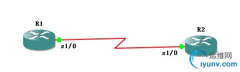

 实验十六、拥塞避免之链路分片和交叉离开(LFIFor Multilink PPP
R1配置:
R1#conf t
R1(config)#int s1/0
R1(config-if)#encapsulation ppp
R1(config-if)#ppp multilink group 1
R1(config-if)#no sh
R1(config-if)#exit
R1(config)#int s1/1
R1(config-if)#no sh
R1(config-if)#exit
R1(config)#int s1/2
R1(config-if)#no sh
R1(config-if)#exit
R1(config)#int multilink 1
R1(config-if)#fair-queue //必须开启WFQ队列机制
R1(config-if)#ppp multilink fragment delay 5
R1(config-if)#ppp multilink interleave
R1(config-if)#exit
R2配置:
R2#conf t
R2(config)#int s1/0
R2(config-if)#encapsulation ppp
R2(config-if)#ppp multilink group 1
R2(config-if)#no sh
R2(config-if)#exit
R2(config)#int s1/1
R2(config-if)#no sh
R2(config-if)#exit
R2(config)#int s1/2
R2(config-if)#no sh
R2(config-if)#exit
R2(config)#int multilink 1
R2(config-if)#fair-queue
R2(config-if)#ppp multilink fragment delay 5
R2(config-if)#ppp multilink interleave
R2(config-if)#exit

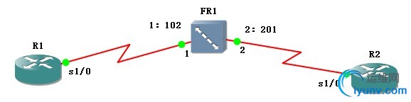

 实验十七、拥塞避免之链路分片和交叉离开(LFIFor 帧中继
R1#conf t
R1(config)#int s1/0
R1(config-if)#frame-relay map ip 192.168.12.2 102
R1(config-if)#frame-relay interface-dlci 102 pppvirtual-Template 1
R1(config-if)#no sh
R1(config-if)#exit
R1(config)#int virtual-template 1
R1(config-if)#ppp multilink fragment delay 4
R1(config-if)#exit
R1(config)#class-map telnet
R1(config-cmap)#match protocol telnet
R1(config-cmap)#exit
R1(config)#class-map http
R1(config-cmap)#match protocol http
R1(config)#class-map bt
R1(config-cmap)#match protocol bittorrent
R1(config)#policy-map PPPCB
R1(config-pmap)#class telnet
R1(config-pmap-c)#priority 64
R1(config-pmap)#class http
R1(config-pmap-c)#bandwidth percent 20
R1(config-pmap)#class bt
R1(config-pmap-c)#drop
R1(config-if)#service-policy output PPPCB
R1(config-if)#exit
R2配置:
R2#conf t
R2(config)#int s1/0
R2(config-if)#frame-relay map ip 192.168.12.1 201
R2(config-if)#frame-relay interface-dlci 201 pppvirtual-Template 1
R2(config-fr-dlci)#clock rate 64000
R2(config-if)#no sh
R2(config-if)#exit
R2(config)#int virtual-template 1
R2(config-if)#ppp multilink fragment delay 4
检查测试:
R1#sh frame-relay pvc 102
PVC Statistics for interface Serial1/0 (Frame>
DLCI = 102, DLCI USAGE = LOCAL, PVC STATUS = ACTIVE,INTERFACE = Serial1/0
  input pkts289           output pkts 355          in bytes 6623
  out bytes8248           dropped pkts 0           in pkts dropped 0
  out pkts dropped0                out bytes dropped 0
  in FECN pkts0           in BECN pkts 0           out FECN pkts 0
  out BECN pkts0          in DE pkts 0             out DE pkts 0
  out bcast pkts0         out bcast bytes 0
  5 minute inputrate 0 bits/sec, 0 packets/sec
  5 minute outputrate 0 bits/sec, 0 packets/sec
  pvc create time00:39:40, last time pvc status changed 00:27:19
  Bound to Virtual-Access1(up, cloned from Virtual-Template1)
R1#sh int virtual-template 1
Virtual-Template1 is down, line protocol is down
  Hardware isVirtual Template interface
  Internet addressis 192.168.12.1/24
  MTU 1500 bytes,BW 100000 Kbit, DLY 100000 usec,
     reliability255/255, txload 1/255, rxload 1/255
  EncapsulationPPP, LCP Closed, multilink Closed, loopback not set
  Keepalive set (10sec)
  DTR is pulsed for5 seconds on reset
  Last input never,output never, output hang never
  Last clearing of"show interface" counters 00:35:03
  Input queue:0/75/0/0 (size/max/drops/flushes); Total output drops: 0
  Queueingstrategy: fifo
  Output queue:0/40 (size/max)
     0 packetsinput, 0 bytes, 0 no buffer
     Received 0broadcasts, 0 runts, 0 giants, 0 throttles
     0 inputerrors, 0 CRC, 0 frame, 0 overrun, 0 ignored, 0 abort
     0 packetsoutput, 0 bytes, 0 underruns

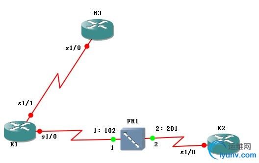

 实验十九、帧中继和PPP中的Payload压缩
R1配置:
R1#conf t
R1(config)#int s1/0
R1(config-if)#frame-relay map ip 192.168.12.2 102broadcast payload-compression packet-by-packet
R1(config-if)#no sh
R1(config-if)#exit
R1(config)#int s1/1
R1(config-if)#ip add 192.168.23.1 255.255.255.0
R1(config-if)#compress lzs
R1(config-if)#no sh
R1(config-if)#exit
R2配置:
R2#conf t
R2(config)#int s1/0
R2(config-if)#frame-relay map ip 192.168.12.1 201broadcast payload-compression packet-by-packet
R2(config-if)#no sh
R2(config-if)#exit
R3配置:
R3#conf t
R3(config)#int s1/0
R3(config-if)#clock rate 64000
R3(config-if)#encapsulation ppp
R3(config-if)#compress lzs
R3(config-if)#no sh
R3(config-if)#exit
检查测试:
R1#ping 192.168.12.2 re 10
Sending 10, 100-byte ICMP Echos to 192.168.12.2, timeoutis 2 seconds:
Success rate is 100 percent (10/10), round-tripmin/avg/max = 16/64/212 ms
R1#ping 192.168.23.3 re 10
Sending 10, 100-byte ICMP Echos to 192.168.23.3, timeoutis 2 seconds:
Success rate is 100 percent (10/10), round-tripmin/avg/max = 4/59/188 ms
R1#sh compress
 Serial1/0
         Softwarecompression enabled
        uncompressed bytes xmt/rcv 2000/2000
         compressedbytes   xmt/rcv 840/830
         Compressedbytes sent:       840 bytes   0 Kbits/sec ratio: 2.380
         Compressedbytes recv:       830 bytes   0 Kbits/sec ratio: 2.409
         1  min avg ratio xmt/rcv 1.831/1.831
         5  min avg ratio xmt/rcv 0.976/1.000
         10 min avgratio xmt/rcv 0.976/1.000
         no bufsxmt 0 no bufs rcv 0
         resyncs 0
         AdditionalStac Stats:
         Transmitbytes:  Uncompressed =        0 Compressed =        840
         Received bytes:  Compressed =        830 Uncompressed =        0
 Serial1/1
        uncompressed bytes xmt/rcv 1349/1340
         compressedbytes   xmt/rcv 575/543
         Compressedbytes sent:       575 bytes   0 Kbits/sec ratio: 2.346
         Compressedbytes recv:       543 bytes   0 Kbits/sec ratio: 2.467
         1  min avg ratio xmt/rcv 0.842/0.920
         5  min avg ratio xmt/rcv 0.251/0.295
         10 min avgratio xmt/rcv 0.205/0.289
         resyncs 0
