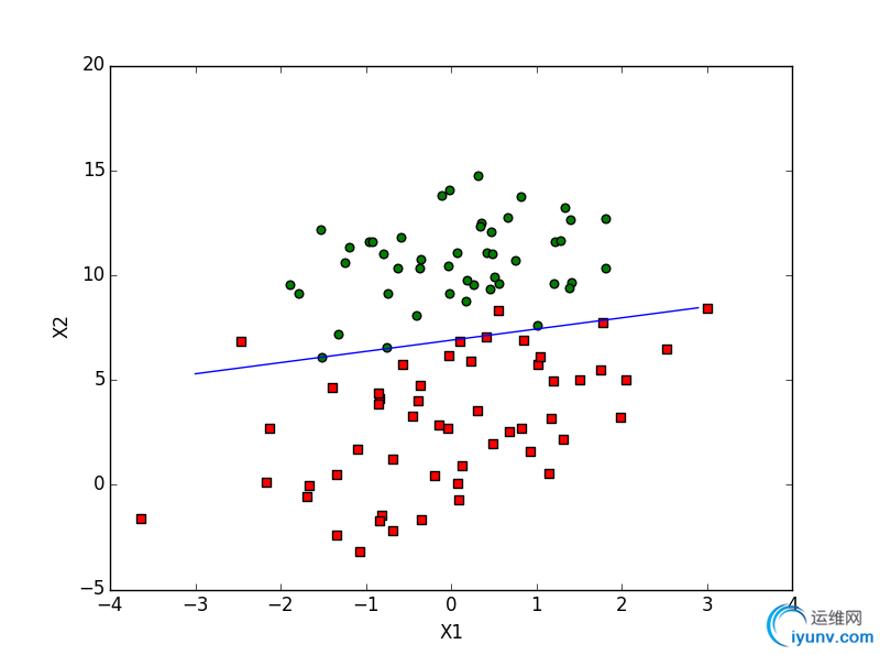

  得到权重后,就可以把图画下来直观的感受下效果了:
  在文本中添加如下的代码:
def plotBestFit(weights):
import matplotlib.pyplot as plt #把pyplot重命名为plt, 方便以后使用
dataMat,labelMat=loadDataSet()
dataArr = array(dataMat)
n = shape(dataArr)[0]
xcord1 = []; ycord1 = []
xcord2 = []; ycord2 = []
for i in range(n):
if int(labelMat)== 1: #标签是1的数据
xcord1.append(dataArr[i,1]); ycord1.append(dataArr[i,2]) #第一维和第二维分别放入xcorde1和ycorde1这两个list中
else: #标签是0的数据
xcord2.append(dataArr[i,1]); ycord2.append(dataArr[i,2]) #第一维和第二维分别放入xcorde2和ycorde2这两个list中
fig = plt.figure()
ax = fig.add_subplot(111)
ax.scatter(xcord1, ycord1, s=30, c='red', marker='s') #标签为1的数据标为红色
ax.scatter(xcord2, ycord2, s=30, c='green')           #标签为0的数据标为绿色
x = arange(-3.0, 3.0, 0.1) #其实这里的x = x1, y = x2; 而x0 = 1
y = (-weights[0]-weights[1]*x)/weights[2] # 0 = weight[0]*x0 + weight[1]*x1 + weight[2]*x2 把分离超平面在二维画出来
    ax.plot(x, y)
plt.xlabel('X1'); plt.ylabel('X2');
plt.show()
  生成如下图示的图片:

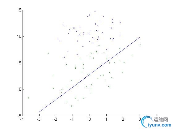

  下面是matlab版本的实现代码:
function returnVals = sigmoid(inX)
returnVals = 1.0 ./ (1.0 + exp(-inX));
end
  上面这个是sigmoid函数, 下面的代码会用到
function weight = gradAscend
clc
close all
clear
data = load('testSet.txt');
[row, col] = size(data); %获取数据的行和列
dataMat = data(:, 1:col-1); %去除data的最后一列
dataMat = [ones(row,1) dataMat];%用列1代替
labelMat = data(:, col); %data矩阵的最后一列作为label矩阵
alpha = 0.001; %步进
maxCycle = 500; %设置最大循环次数
weight = ones(col, 1); %初始化权值值
for i = 1:maxCycle
h = sigmoid(dataMat * weight); %logistic回归的hypothesis
error = labelMat - h;
weight = weight + alpha * dataMat' * error;
end
figure
scatter(dataMat(find(labelMat(:) == 0), 2), dataMat(find(labelMat(:) == 0), 3), 3);
hold on
scatter(dataMat(find(labelMat(:) == 1), 2), dataMat(find(labelMat(:) == 1), 3), 5);
hold on
x = -3:0.1:3;
y = (-weight(1)-weight(2)*x)/weight(3);
plot(x.y)
hold off
end
  效果如下:

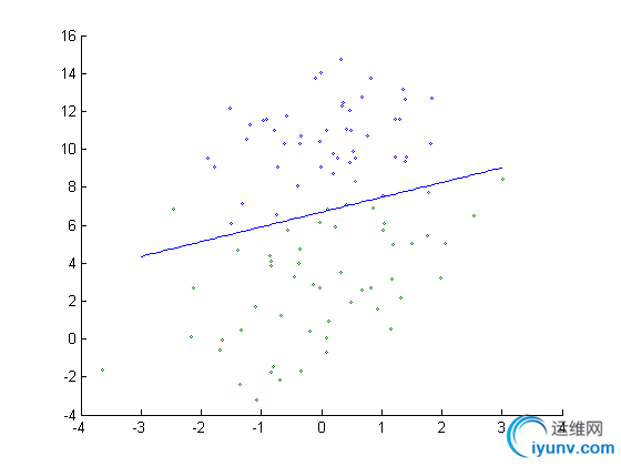

  2. 随机梯度上升
  梯度上升算法在每次更新回归系数时需要遍历这个数据集, 倘若数据集规模较大时, 时间空间的复杂度就难以承受了, 一种新的办法是每次只用一个样本点更新回归系数, 这种方法称为随机梯度上升.
  在原文本中插入一下代码:
def stocGradAscent0(dataMatrix, classLabels):
m,n = shape(dataMatrix)
alpha = 0.01 #设定步进值为0.1
weights = ones(n)   #初始化权值
for i in range(m): #每次只选取一个点进行权值的更新运算可节省不少时间
h = sigmoid(sum(dataMatrix*weights))
error = classLabels - h
weights = weights + alpha * error * dataMatrix
return weights
  在python命令行窗口输入下述命令:
>>> reload(logRegres)
>>> dataArr,labelMat=logRegres.loadDataSet()
>>> weights=logRegres.stocGradAscent0(array(dataArr),labelMat)
>>> logRegres.plotBestFit(weights)
  得到如下的图形:
  matlab版本的代码如下:
function stocGradAscent
% Description : LogisticRegression using stocGradAsscent
% Author : Liulongpo
% Time:2015-4-18 10:57:25
clc
clear
close all
[row , col] = size(data);
dataMat = [ones(row,1) data(:,1:col-1)];
alpha = 0.01;
labelMat = data(:,col);
weight = ones(col,1);
for i = 1:row
h = sigmoid(dataMat(i,:)*weight);
error = labelMat(i) - h;
weight = weight + alpha * error * dataMat(i,:)'
end
figure
scatter(dataMat(find(labelMat(:)==0),2),dataMat(find(labelMat(:)==0),3),5);
hold on
scatter(dataMat(find(labelMat(:) == 1),2),dataMat(find(labelMat(:) == 1),3),5);
hold on
x = -3:0.1:3;
y = -(weight(1)+weight(2)*x)/weight(3);
plot(x,y)
hold off
end
  效果图如下所示:

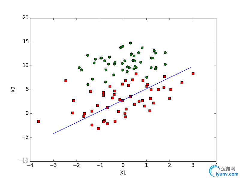

  似乎效果不太好, 因为训练的次数比较少, 只一轮, 下面修改代码, 并改进其它的一些问题:
def stocGradAscent1(dataMatrix, classLabels, numIter=150): #可自己设定更新的轮数,默认为150
for j in range(numIter): #第j轮
dataIndex = range(m)
for i in range(m): #第j轮中的第i个数据
alpha = 4/(1.0+j+i)+0.0001    #alpha会随着更新的次数增加而越来越小
randIndex = int(random.uniform(0,len(dataIndex)))#每次的i循环的randIndex的值都不同
h = sigmoid(sum(dataMatrix[randIndex]*weights))
error = classLabels[randIndex] - h
weights = weights + alpha * error * dataMatrix[randIndex]
del(dataIndex[randIndex])
return weights
  一个重要的改进是alpha 的值不再是一个固定的值, 而是会随着更新的次数增加而越来越小, 但0.0001是它的下限.
  还有一个改进是 每轮的更新不会按照既有的顺序, 这样可以避免权值周期性的波动.
  下面是150轮后的图形:
  可以看到, 随机梯度上升算法比梯度上升算法收敛的更快.

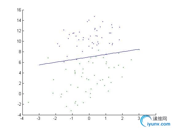

  下面是matlab的版本:
function ImproveStocGradAscent
clc
clear
close all
numIter = 150;
for j = 1: numIter
for i = 1:row
alpha = 4/(1.0+j+i) + 0.0001;
randIndex = randi(row); %产生1到100间的随机数
h = sigmoid(dataMat(randIndex,:)*weight);
error = labelMat(randIndex) - h;
weight = weight + alpha * error * dataMat(randIndex,:)';
end
end
figure
hold on
hold on
x = -3:0.1:3;
plot(x,y)
hold off
end
  效果如下:
