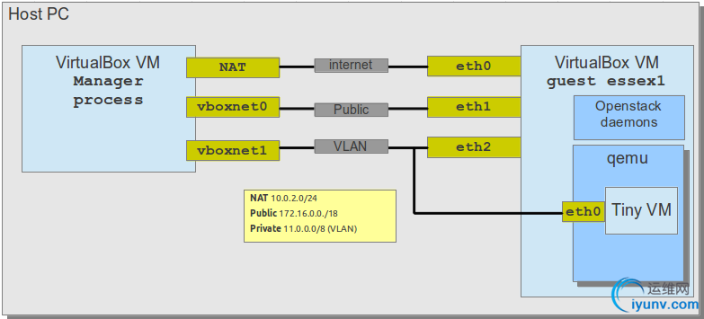

We will install VirtualBox on whatever host OS you have (provided it runs VirtualBox, even Windows). After configuring VirtualBox's host-only network adapetrs, we will create a VM (named essex1) in which a fresh ISO of Ubuntu 12.04 will be installed. All subsequent actions are performed inside essex1. We will grab Kevin's script (credits below) which will do most of the installation and configuration work. Then we will download a tiny(很小的) cloud-ready image, from which we will create our “cloud instance”. OpenStack's Dashboard will be used to launch this instance, we will end the session logging into the cloud instance.
--安装VirtualBox
--配置VirtualBox的网络中Host-only network adapter.
--创建一个虚拟机,叫essex1,在其上安装Ubuntu 12.04。
--使用Kevin's script 执行安装和配置工作
--下载一个小的cloud-ready 镜像,在其上创建我们的cloud instance
--openstack的Dashboard用来加载这个实例,然后就可以登陆这个cloud instance了。

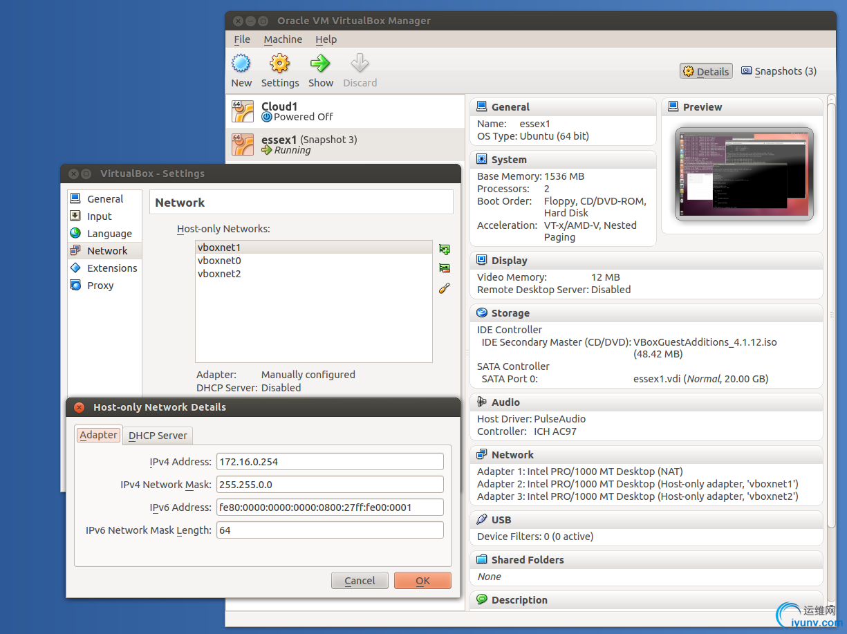

  • Configure VirtualBox's Host-Only Networks
  start VirtualBox [on ubuntu prior to Unity it's in Applications → Accessories]
  open File → Preferences → Network tab
  Add host-only netwok for vboxnet0 – this will be the Public interface
  set IP to 172.16.0.254, mask 255.255.0.0, dhcp disbaled
  Add host-only netwok for vboxnet1 – this will be the Private (VLAN) interface
  set IP to 11.0.0.1, mask 255.0.0.0, dhcp disbaled
  Note1: In Kevin's screencast, vboxnet1 is set to 10.0.0.1 which is also used by the default D-Link router (from Bezeq). There shouldn't be IP addressing issues since VirtualBox is supposed to take care of isolation – but I had IP clashes and therefore suggest 11.0.0.0/8 instead.
  Note2: In my screenshots vboxnet0 is assigned to another test, so I use vboxnet1 and vboxnet2 respectively

Now modify the guest as follows: (performed from the right panel in VirtualBox's main window, where the new VM is selected on the left).
System tab:
Processor (optional, but recommended): Increase CPU from 1 set to 2
Acceleration: make sure VT-x and nested paging are checked
Network tab: see figure above
Adapter 1: attached to NAT – eth0 will connect here;
Adapter 2: attached to Host-Only Adapter, vboxnet0 - eth1 will connect here ;
Adapter 3: attached to Host-Only Adapter, vboxnet1 - eth2 will connect here;

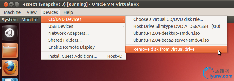

VirtualBox should popup a wizard to connect the ISO file as boot device.
Note: If this doesnt happen (e.g. this isn't your first attmept to boot the VM), you may use the Storage tab to hook the ISO to the virtual CD drive. Alternatively, use the VM window's Devices menu to do the same.
(VB会弹出个向导来连接ISO文件,如果没有,点击启动的时候,会提供选择ISO)

 when prompted to reboot, disconnect the ISO from the CD
