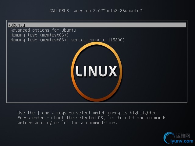

  The typical grub will look like below.
cat /etc/default/grub
  Sample output:

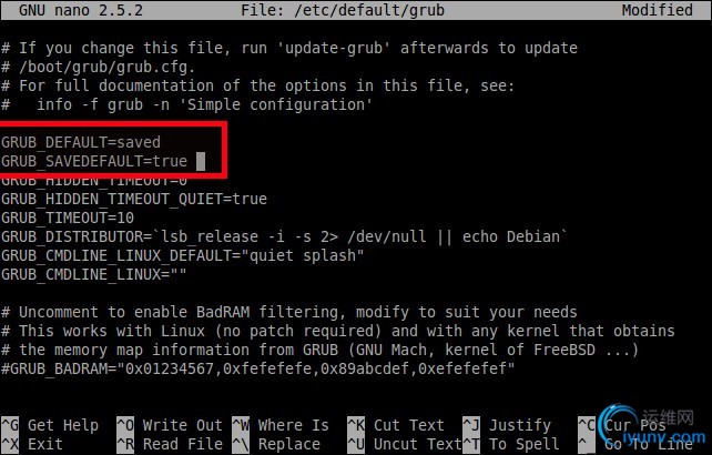

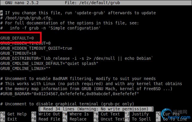

1. Select default OS (GRUB_DEFAULT)
We can select the default OS to boot using this option. If you set the value as “0”, the first operating system in the GRUB boot menu entry will boot. If you set it as “1”, the second OS will boot, and so on.
Also, if you have more than one OS in your system, you can boot the last operating system using the value GRUB_DEFAULT=saved. Whenever you reboot the system, the last operating system will start boot. Please note that you should add a line GRUB_SAVEDEFAULT=true to make this trick work.
