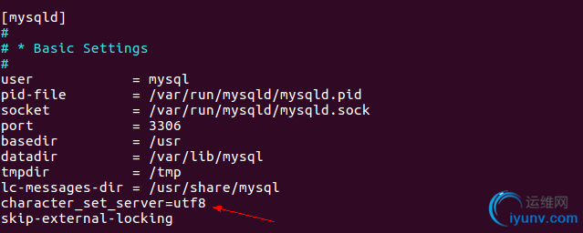

    (1)编辑配置文件。sudo vi /etc/mysql/mysql.conf.d/mysqld.cnf
    (2)在[mysqld]下添加一行character_set_server=utf8。如下图
    (3)重启MySQL服务。service mysql restart
    (4)登陆MySQL,并查看MySQL目前设置的编码show variables like "char%";
