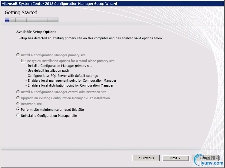

  •   Start Configuration Manager Setup either from the start menu or the  installation source.
  •   Select the “Perform site maintenance or reset Site” option

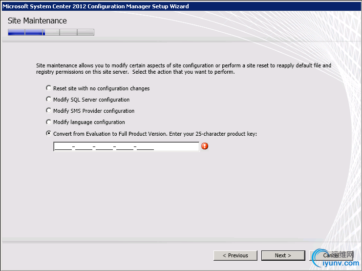

  •   Then you get the option to “Convert from Evaluation to Full Product Version. Enter your 25-character product key:”

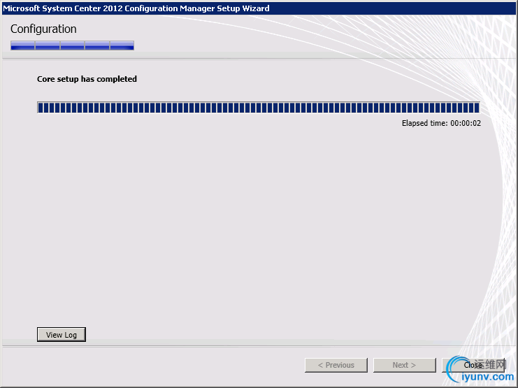

  •   In the next screen accept the license agreement
  •   Finished!
    DSC0003.png It is truly a great feature that is so easy to convert from an installation using the Evaluation License to a Licensed product, it makes Proof-of-concepts much easier to perform and afterwards upgrade the environment to a licensed product in minutes.
