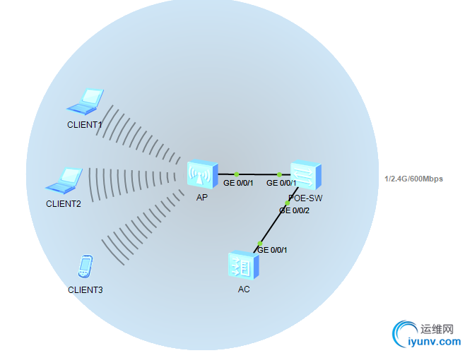

  配置Switch
  [Switch]vlan batch 100 101102    //创建管理Vlan100、业务vlan101、102
  [Switch]interface g0/0/1          //进入端口G0/0/1
  [Switch-GigabitEthernet0/0/1]descriptionlink-ap
  [Switch-GigabitEthernet0/0/1]portlink-type trunk    //端口模式为trunk
  [Switch-GigabitEth0ernet0/0/1]porttrunk pvid vlan 100
  //给接AP的端口打上管理vlan100的PVID
  [Switch-GigabitEthernet0/0/1]porttrunk allow-pass vlan 100 101
  //定义该端口允许通过的vlan
  [Switch-GigabitEthernet0/0/1]quit
  [Switch]interfaceGigabitEthernet0/0/2    //进入G0/0/2,与g/0/1同理
  [Switch-GigabitEthernet0/0/2]portlink-type trunk
  [Switch-GigabitEthernet0/0/2]porttrunk allow-pass vlan 100 101
  [Switch-GigabitEthernet0/0/2]quit
  配置AC
  1. 配置接口和VLAN信息,AC为DHCP Server,为AP和client分配地址
  [AC]vlan batch 100 101 102    //在AC上创建管理vlan100、业务vlan101、102
  [AC]interfaceGigabitEthernet0/0/1  //进入端口
  [AC-GigabitEthernet0/0/1]portlink-type trunk  //定义端口模式
  [AC-GigabitEthernet0/0/1]porttrunk allow-pass vlan 100 101
  //定义允许通过的vlan
  [AC-GigabitEthernet0/0/1]quit

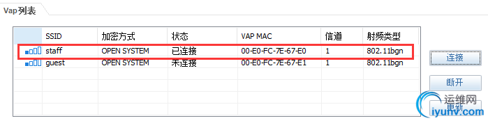

  #创建服务集并绑定WLAN-ESS接口、安全模板和流量模板
  [AC-wlan-view]service-setname service-set-0
  [AC-wlan-service-set-service-set-0]ssidstaff
  [AC-wlan-service-set-service-set-0]wlan-ess1
  [AC-wlan-service-set-service-set-0]service-vlan101
  [AC-wlan-service-set-service-set-0]security-profilename security-profile-0
  [AC-wlan-service-set-service-set-0]traffic-profilename traffic-profile-0

  #配置VAP并下发

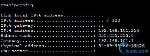

  [AC-wlan-view]ap 0 radio 0
  [AC-wlan-radio-0/0]radio-profilename radio-profile-0
  [AC-wlan-radio-0/0]service-setname service-set-0
  [AC-wlan-radio-0/0]quit
  [AC-wlan-view]commit ap 0
