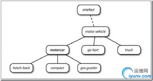

  The WordNet Hierarchy WordNet层次结构
  WordNet synsets correspond to abstract concepts(抽象的概念), and they don’t always have corresponding words in English. These concepts are linked together in a hierarchy. Some concepts are very general, such as Entity, State, Event; these are called unique beginnersor root synsets(根同义词集). Others, such as gas guzzler(油老虎) and hatchback(带掀式后背的小轿车), are much more specific. A small portion of a concept hierarchy is illustrated in Figure 2-8.
  Figure 2-8. Fragment of WordNet concept hierarchy: Nodes correspond to synsets; edges indicate the hypernym(上位词)/hyponym(下位词) relation, i.e., the relation between superordinate(同hypernym) and subordinate(从属的) concepts
  WordNet makes it easy to navigate between concepts. For example, given a concept like motorcar, we can look at the concepts that are more specific—the (immediate) hyponyms.
