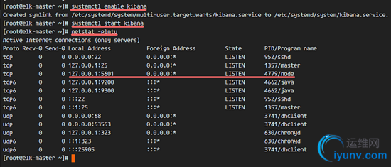

  Add Kibana to run at boot and start it.
  sudo systemctl enable kibana
  sudo systemctl start kibana
  Kibana will run on port 5601 as node application.
  netstat -plntu

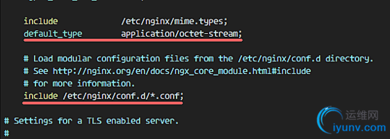

  Edit the Nginx configuration file and remove the 'server { }' block, so we can add a new virtual host configuration.
  cd /etc/nginx/
  vim nginx.conf
  Remove the server { } block.
  Save the file and exit vim.

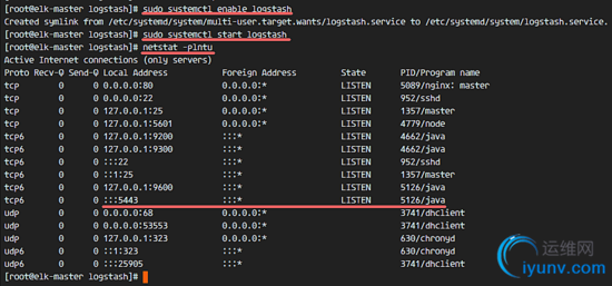

  Finally add logstash to start at boot time and start the service.
  sudo systemctl enable logstash
  sudo systemctl start logstash

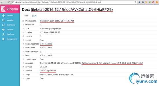

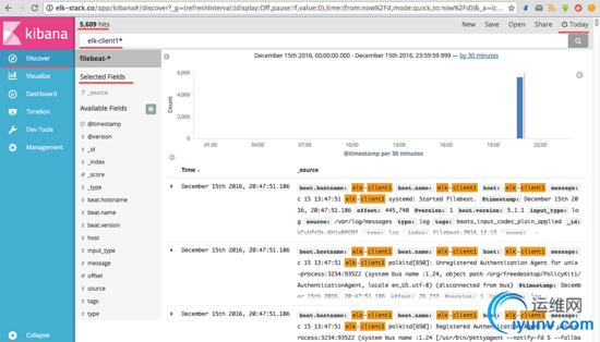

Step 6 - Install and Configure Filebeat on the CentOS Client
  Beats are data shippers, lightweight agents that can be installed on the client nodes to send huge amounts of data from the client machine to the Logstash or Elasticsearch server. There are 4 beats available, 'Filebeat' for 'Log Files', 'Metricbeat' for 'Metrics', 'Packetbeat' for 'Network Data' and 'Winlogbeat' for the Windows client 'Event Log'.
  In this tutorial, I will show you how to install and configure 'Filebeat' to transfer data log files to the Logstash server over an SSL connection.
  Login to the client1 server. Then copy the certificate file from the elastic server to the client1 server.
  ssh root@client1IP
  Copy the certificate file with the scp command.
  scp root@elk-serverIP:~/logstash-forwarder.crt .
  TYPE elk-server password
  Create a new directory and move certificate file to that directory.
  sudo mkdir -p /etc/pki/tls/certs/
  mv ~/logstash-forwarder.crt /etc/pki/tls/certs/
  Next, import the elastic key on the client1 server.
  rpm --import https://artifacts.elastic.co/GPG-KEY-elasticsearch
  Download Filebeat and install it with rpm.
  wget https://artifacts.elastic.co/downloads/beats/filebeat/filebeat-5.1.1-x86_64.rpm
  rpm -ivh filebeat-5.1.1-x86_64.rpm
  Filebeat has been installed, go to the configuration directory and edit the file 'filebeat.yml'.
  cd /etc/filebeat/
  vim filebeat.yml
  In the paths section on line 21, add the new log files. We will add two files '/var/log/secure' for ssh activity and '/var/log/messages' for the server log.
  paths:
  - /var/log/secure
  - /var/log/messages
  Add a new configuration on line 26 to define the syslog type files.
  document-type: syslog
  Filebeat is using Elasticsearch as the output target by default. In this tutorial, we will change it to Logshtash. Disable Elasticsearch output by adding comments on the lines 83 and 85.
  Disable elasticsearch output.
  #-------------------------- Elasticsearch output ------------------------------
  #output.elasticsearch:
  # Array of hosts to connect to.
  #  hosts: ["localhost:9200"]
  Now add the new logstash output configuration. Uncomment the logstash output configuration and change all value to the configuration that is shown below.
  output.logstash:
  # The Logstash hosts
  hosts: ["10.0.15.10:5443"]
  bulk_max_size: 1024
  ssl.certificate_authorities: ["/etc/pki/tls/certs/logstash-forwarder.crt"]
  template.name: "filebeat"
  template.path: "filebeat.template.json"
  template.overwrite: false
  Add Filebeat to start at boot time and start it.
  sudo systemctl enable filebeat
  sudo systemctl start filebeat

  Open your web browser and visit the elastic stack domain that you used in the Nginx configuration,  mine is 'elk-stack.co'. Login as admin user with your password and press Enter to log in to the Kibana dashboard.
  Create a new default index 'filebeat-*' and click on the 'Create' button.
  Th default index has been created. If you have multiple beats on the elastic stack, you can configure the default beat with just one click on the 'star' button.
  Go to the 'Discover' menu and you will see all the log file from the elk-client1 and elk-client2 servers.
  An example of JSON output from the elk-client1 server log for an invalid ssh login.
