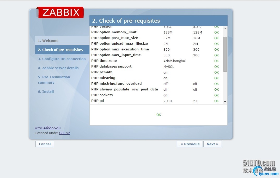

五、问题来了
红色出现错误,一直困惑了我一天,换几个版本PHP编译也是一个样,后面查看官方文档,不明觉厉啊

然后按官方手册,mbstring.func_overload 必须关闭,lways_populate_raw_post_data option必须设为1,检测就通过了
养成看官文文档习惯!

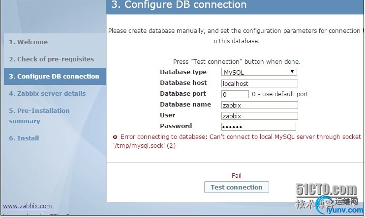

六、连接数据库问题
1、检查了配置文件zabbix_server.conf
[iyunv@dc2 zabbix]# cat /etc/zabbix/zabbix_server.conf
DBSocket=/data0/mysql/data3308/mysql.sock
my.cnf的配置文件
[iyunv@dcserver2 zabbix]# cat /etc/my.cnf
[mysqld3308]
basedir = /usr/local/mysql/
datadir = /data0/mysql/data3308
socket = /data0/mysql/data3308/mysql.sock  //socket指定是一样
pid-file = /data0/mysql/data3308/mysqld.pid
user = mysql
port = 3308
skip_external_locking
back_log = 384
key_buffer_size = 256M
max_allowed_packet = 4M
thread_stack = 256K
table_open_cache = 128K
sort_buffer_size = 6M
read_buffer_size = 4M
join_buffer_size = 8M
myisam_sort_buffer_size = 64M
thread_cache_size = 64
query_cache_size = 64M
tmp_table_size = 256M
max_connections = 768
max_connect_errors = 10000000
#wait_timeout = 10
thread_concurrency = 8
explicit_defaults_for_timestamp = TRUE
event_scheduler=on
2、但还是显示默认只连接socket=/tmp/mysql.sock路径下,百思不理其解,因为mysql多事例的,所以
[iyunv@dc2 zabbix]# ln -sf /data0/mysql/data3308/mysql.sock /tmp/mysql.sock
既然解决test 通过了,治标不治本。虽然可以通过,但问什么在zabbix_server.conf没有生效这个指socket路径文件呢

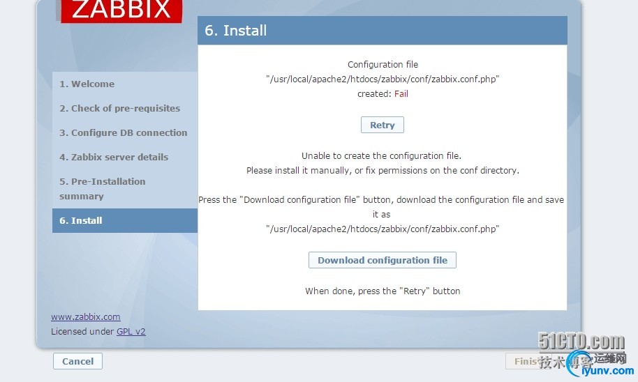

七、最后一步手动创建配置文件
1、在这里还纠吉个把小时,点击Download下载,按它提示,复制到指定目录下,并设好属主组apache,结果点击重试,还是不行。琢磨着
[iyunv@dcserver2 conf]# ll
总用量 12
-rw-r--r--. 1 apache apache 1036 6月  26 19:27 maintenance.inc.php
-rw-r--r--. 1 apache apache  429 6月  26 19:27 zabbix.conf.php.example
[iyunv@dcserver2 conf]# pwd
/usr/local/apache2/htdocs/zabbix/php/conf
2、打开它样列文件
[iyunv@dcserver2 conf]# vim zabbix.conf.php.example
<?php
// Zabbix GUI configuration file.
global $DB;
$DB["TYPE"]                             = 'MYSQL';
$DB["SERVER"]                   = 'localhost';
$DB["PORT"]                             = '0';
$DB["DATABASE"]                 = 'zabbix';
$DB["USER"]                             = 'zabbix';
$DB["PASSWORD"]                 = 'zabbix_password';
// Schema name. Used for IBM DB2 and PostgreSQL.
$DB["SCHEMA"]                   = '';
$ZBX_SERVER                             = 'localhost';
$ZBX_SERVER_PORT                = '10051';
$ZBX_SERVER_NAME                = '';
$IMAGE_FORMAT_DEFAULT   = IMAGE_FORMAT_PNG;
3、看来按着上面提示下载文件,是错的。按着这个样例文件,填写上去

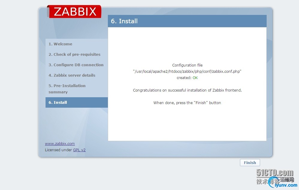

[iyunv@dcserver2 conf]# cp zabbix.conf.php.example zabbix.conf.php;vim zabbix.conf.php
<?php
global $DB;
$DB["PORT"]                             = '3308';
$DB["PASSWORD"]                 = '11111';
$DB["SCHEMA"]                   = '';
$ZBX_SERVER_NAME                = 'zabbix-server';

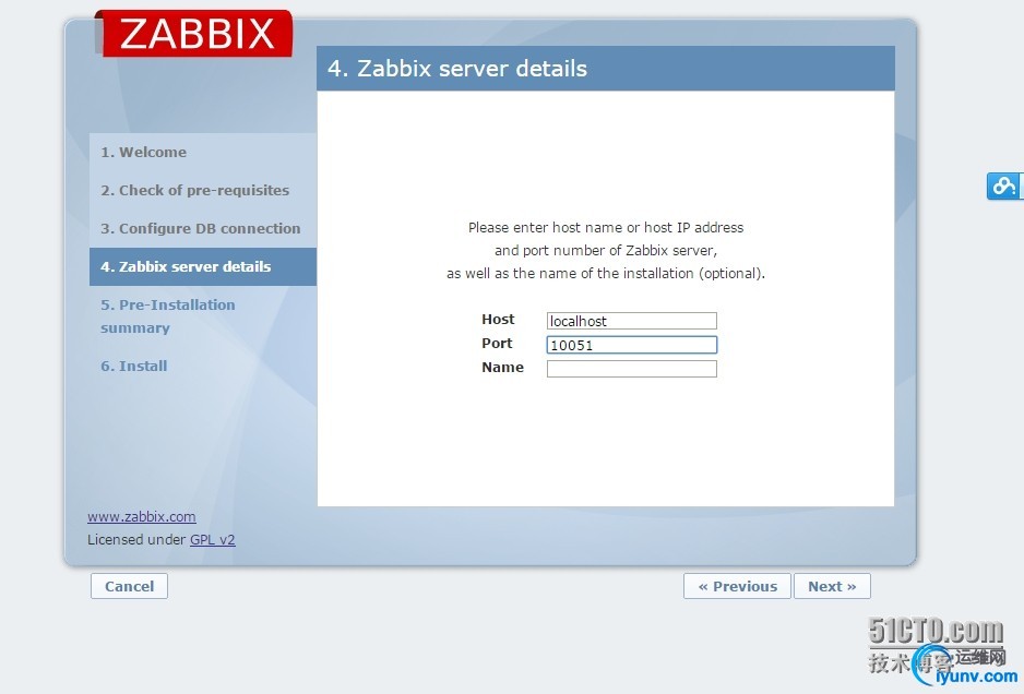

4、保存后,再点重试,OK,算是始始化完成了
