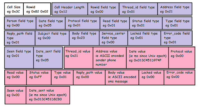

So for our Android SMS scenario, a typical used "sms" data cell might look like:
Android SMS Cell Example
You'll notice that there's a "Cell Header" section highlighted in purple and a "Cell Data" section highlighted in pink.
Think of the Cell Header section as a template that tells us how many bytes to expect for each field in the Cell Data section. The Cell Data section does not use varints to store data.
From the sms-cell-example pic, we can see that most of the Cell Header field types are 0x01 - which means those fields use one byte of data in the subsequent cell data section (pink).
The official SQLite documentation refers to these cell header field type values as "Serial Type Codes" and there's a comprehensive definition table about halfway down the page here.
For our sms example, we can see from the purple section that the sms "Read" and "Type" fields will use 1 byte each to store their data in the Cell Data (pink) section. Looking at the pink section confirms this - the "Read" field value is 0 (0 for unread, 1 for read) and the "Type" field is 1 (1 for received, 2 for sent).
As a rule, if the value of the cell header field type (purple section) is between 0x0 and 0x4, the corresponding data field (pink) will use that many bytes (eg 0x1 means 1 byte data field, 0x4 means 4 bytes)
If the value of a cell header field (purple section) is 0x5 (eg "Date" & "Date_sent" fields), it will take 6 bytes in the cell data (pink) section. The "Date" and "Date_sent" data fields are 6 byte Big Endian values which (for Android) contain the number of milliseconds since the Unix epoch (1 Jan 1970).
There's a special case for handling strings. Firstly, the cell header field type value must be odd and greater than or equal to 13. Then to calculate the number of bytes required in the data section we use this:
Number of bytes in string = (cell header field type value - 13)/2.
So in our sms-cell-example pic, the corresponding string size for the "Address" field is (0x21 - 0xD) / 0x2 = (33 - 13) / 2 = 10 bytes. I haven't actually shown a value for the "Address" in the pink section so just use your imagination!
Similarly, we can see that the "Body" field will take (0x23 - D) / 0x2 = (35 - 13) / 2 = 11 bytes.
Note: For long sms, the varint containing the "body" header field type has been observed to require 2 bytes.
You might also have noticed that not all of the cell header fields declared in the cell header section (purple) have a matching entry in the cell data section (pink). This is because if a cell header field is marked as NULL (ie 0x00), it does not get recorded in the cell data section (eg the purple "Rowid" header field's 0x00 value means there won't be a corresponding data field in the pink section).
So if we want to retrieve data, we can't go strictly off the schema - we have to pay attention to the cell header section so we can interpret the cell data fields correctly.

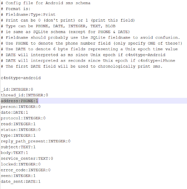

Here's an example of a configuration file (also provided from my GoogleCode Download page as "sms-grep-sample-config.txt"):
Sample Android configuration file
Notice that it's very similar to the schema we got earlier from sqlite3?
The most significant differences are:
- "address" field (which is now listed as a PHONE type)
- "date" field (which is now listed as a DATE type)
- "date_sent" field (which is now listed as a DATE type)
- the configuration file uses ":" as a field separator (sqlite3 uses "|")
- the print flags (1 prints the field value, 0 does not print)
The script will ignore any blank lines and lines starting with "#".
