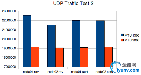

Now, what you see is already improving. For the 4 hour test, the amount of extra UDP packets sent with an MTU size of 1500 compared to an MTU size of 9000 is about 2.5 to 3 million, see this chart:
Imagine yourself what an impact this has. Each package you not send save you the network-overhead of the package itself and a lot of CPU cycles that you don't need to spend.
The load average of the Linux box also decreases from an avg of 16 to 14.

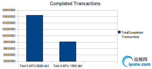

In terms of completed transactions on different MTU sizes within the same timeframe, the chart looks like this:

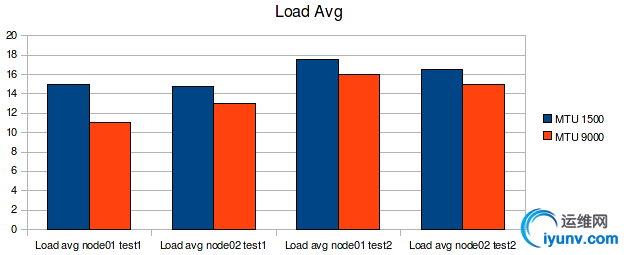

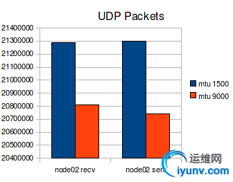

To conclude this test two very high load runs are performed. Again, one with an MTU of 1500 and one with an MTU of 9000.
In the charts below you will see less CPU consumption when using 9000 bytes for MTU.
Also less packets are sent, although I think that number is not that significant compared to the total number of packets sent.

2. you will notice the benefits of Jumbo using Frames on a stressed system and such a system will then use less CPU and will have less network overhead.
This means Jumbo Frames help you scaling out better then regular frames.
