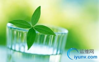

$jpgResize = new ResizeImage("img/test_1920_1200.jpg", 320, 240, false, "img/test_320_240.jpg");
//png

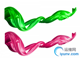

$pngResize = new ResizeImage("img/test_1024_746.png", 320, 240, false, "img/test_320_240.png");
效果
