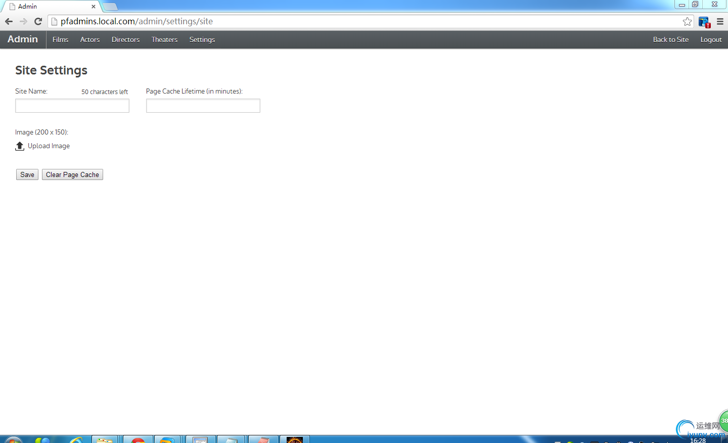

5、生成Laravel-Administrator配置
  php artisan config:publish frozennode/administrator #生成配置
vim app/config/packages/frozennode/administrator/administrator.php #你可以编辑此文件配置后台参数
6、配置Laravel-Administrator例子
  如果没有示例我们也不知道如何开始,那么就让我们看看这个插件包所给出的例子吧。
  cd ../ #退到工作目录
git clone https://github.com/FrozenNode/Laravel-Administrator #下载插件
cp Laravel-Administrator/examples/app/config/packages/frozennode/administrator/administrator.php your-project-name/app/config/packages/frozennode/administrator/
cp Laravel-Administrator/examples/app/config/administrator your-project-name/app/config/ -r
cp Laravel-Administrator/examples/app/models your-project-name/app/ -r
cp Laravel-Administrator/examples/app/database/migrations/* your-project-name/app/database/migrations/
mkdir -p your-project-name/public/packages/frozennode/administrator
cp Laravel-Administrator/public/* your-project-name/public/packages/frozennode/administrator/ -r

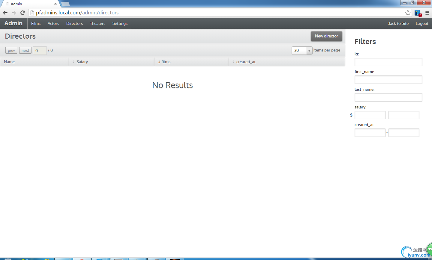

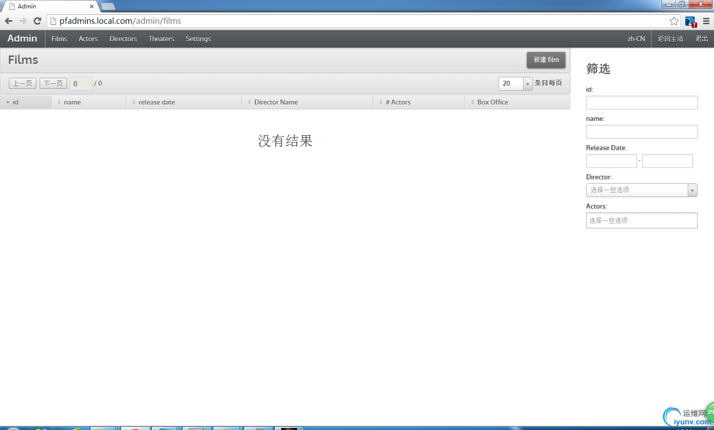

  将服务器IP与你的域名绑定,开始浏览,我这里的地址为http://pfadmins.local.com/admin。一定要加上admin,因为后台的url就在admin,当然你可以配置。
