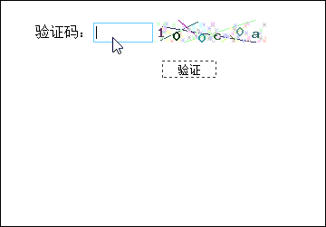

<div id="testcode">
<form method="post" name="verification" action="verification-code.php?action=verification">
<dl>
<dd>验证码:<input type="text" name="code" class="code" /><img src="codeimg.php" id="codeimg"  /></dd>
<dd><input type="submit" class="submit" value="验证" /></dd>
</dl>
</form>
</div>
</body>
</html>
  显示如下:
