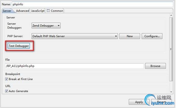

  5.Zend StudioTools->preferences->debug下核对一下设置是正确的
  6.测试Debugger是否成功

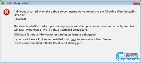

问题:Test Debugger报错
“A timeout occurred when the debug server attempter to connect to the following client hosts/IPS”
所以注意了:如果你的php版本是5.3以上,且是thread safe的,那么不要浪费你的时间做尝试,建议你直接改用XDebug吧。以下官方给出的解释。
The Debugger we provide supports only the non-thread-safe architecture, that is why it does not load in your configuration.
Zend stopped supporting the thread safe architecture when Microsoft also decided to implement its PHP engine with the fast-cgi architecture which means non-thread-safe.
Best regards,
Massi.
