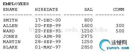

17. View the E xhibitand examine the data in the EMPLOYEES table.
You want to generate areport showing the total compensation paid to each employee to date.
You issue the followingquery:
SQL>SELECT ename||  ' joined on ' || hiredate ||
', the totalcompensation paid is ' ||
TO_CHAR(ROUND(ROUND(SYSDATE-hiredate)/365)* sal + comm)
"COMPENSATION UNTILDATE"
FROM emp;
What is the outcome?
http://blog.iyunv.com/zbdba/article/details/17053631 Center.jpg
A. It generates an errorbecause the alias is not valid.
B. It executessuccessfully and gives the correct output.
C. It executessuccessfully but does not give the correct output.
D. It generates an errorbecause the usage of the ROUND function in the expression is not valid.
E. It generates an errorbecause the concatenation operator can be used to combine only two items.
Answer: C
解析:能正确执行,但是不能得到正确的结果
scott@ORCL>
scott@ORCL>SELECTename ||  ' joined on ' || hiredate ||
  2  ',the total compensation paid is ' ||
  3 TO_CHAR(ROUND(ROUND(SYSDATE-hiredate)/365) * sal + comm)
  4 "COMPENSATION UNTIL DATE"
  5  FROMemp;
SMITH joined on 17-12月-80, the total compensation paid is
ALLEN joined on 20-2月 -81, the total compensation paid is 52960
WARD joined on 22-2月 -81, the total compensation paid is 41750
JONES joined on 02-4月 -81, the total compensation paid is
MARTIN joined on 28-9月 -81, the total compensation paid is 41400
BLAKE joined on 01-5月 -81, the total compensation paid is
CLARK joined on 09-6月 -81, the total compensation paid is
SCOTT joined on 19-4月 -87, the total compensation paid is
KING joined on 17-11月-81, the total compensation paid is
TURNER joined on 08-9月 -81, the total compensation paid is 48000
ADAMS joined on 23-5月 -87, the total compensation paid is
JAMES joined on 03-12月-81, the total compensation paid is
FORD joined on 03-12月-81, the total compensation paid is
MILLER joined on 23-1月 -82, the total compensation paid is
已选择14行。
发现奖金为空的,最后得不到结果
scott@ORCL>select1000+comm from emp where empno=7369;
1000+COMM
在oracle中如果如果不出来空值,任何数相加都会得到空值
scott@ORCL>select1000+nvl(comm,0) from emp where empno=7369;
1000+NVL(COMM,0)
            1000
