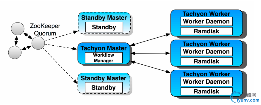

  3.1 HA架构

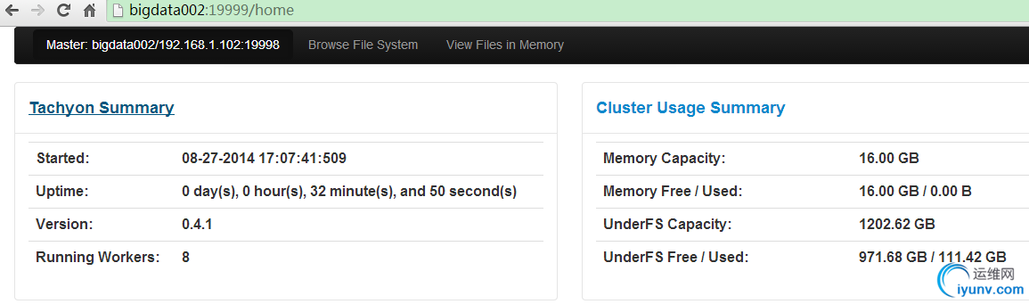

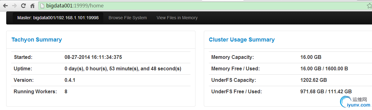

  4.测试HA
  web界面查看:http://bigdata001:19999
  kill掉bigdata001的master进程,切换时间大概需要20s,再次查看新的Web UI:http://bigdata002:19999/home
