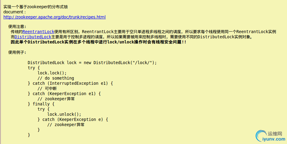

代码

public class DistributedLock {
private static final byte[]  data      = { 0x12, 0x34 };
private ZooKeeperx           zookeeper = ZooKeeperClient.getInstance();
private final String         root;                                     //根节点路径
private String               id;
private LockNode             idName;
private String               ownerId;
private String               lastChildId;
private Throwable            other     = null;
private KeeperException      exception = null;
private InterruptedException interrupt = null;
public DistributedLock(String root) {
this.root = root;
ensureExists(root);

* 返回锁对象对应的path
public String getRoot() {
return root;
* 判断当前是不是锁的owner
public boolean isOwner() {
return id != null && ownerId != null && id.equals(ownerId);
* 返回当前的节点id
public String getId() {
return this.id;
// ===================== helper method =============================
* 执行lock操作,允许传递watch变量控制是否需要阻塞lock操作
private Boolean acquireLock(final BooleanMutex mutex) {
try {
do {
if (id == null) {//构建当前lock的唯一标识
long sessionId = zookeeper.getDelegate().getSessionId();
String prefix = "x-" + sessionId + "-";
//如果第一次,则创建一个节点
String path = zookeeper.create(root + "/" + prefix, data,
CreateMode.EPHEMERAL_SEQUENTIAL);
int index = path.lastIndexOf("/");
id = StringUtils.substring(path, index + 1);
idName = new LockNode(id);
if (id != null) {
List<String> names = zookeeper.getChildren(root, false);
if (names.isEmpty()) {
id = null;//异常情况,重新创建一个
} else {
//对节点进行排序
SortedSet<LockNode> sortedNames = new TreeSet<LockNode>();
for (String name : names) {
sortedNames.add(new LockNode(name));
if (sortedNames.contains(idName) == false) {
id = null;//清空为null,重新创建一个
continue;
//将第一个节点做为ownerId
ownerId = sortedNames.first().getName();
if (mutex != null && isOwner()) {
mutex.set(true);//直接更新状态,返回
return true;
} else if (mutex == null) {
return isOwner();
SortedSet<LockNode> lessThanMe = sortedNames.headSet(idName);
if (!lessThanMe.isEmpty()) {
//关注一下排队在自己之前的最近的一个节点
LockNode lastChildName = lessThanMe.last();
lastChildId = lastChildName.getName();
//异步watcher处理
zookeeper.exists(root + "/" + lastChildId, new AsyncWatcher() {
public void asyncProcess(WatchedEvent event) {
acquireLock(mutex);
if (stat == null) {
acquireLock(mutex);// 如果节点不存在,需要自己重新触发一下,watcher不会被挂上去
} else {
if (isOwner()) {
mutex.set(true);
} else {
id = null;// 可能自己的节点已超时挂了,所以id和ownerId不相同
} while (id == null);
} catch (KeeperException e) {
exception = e;
if (mutex != null) {
mutex.set(true);
} catch (InterruptedException e) {
interrupt = e;
mutex.set(true);
} catch (Throwable e) {
other = e;
mutex.set(true);
if (isOwner() && mutex != null) {
mutex.set(true);
return Boolean.FALSE;
  相关说明:
  测试代码:
  • @Test
  •     public void test_lock() {
  •         ExecutorService exeucotr = Executors.newCachedThreadPool();
  •         final int count = 50;
  •         final CountDownLatch latch = new CountDownLatch(count);
  •         final DistributedLock[] nodes = new DistributedLock[count];
  •         for (int i = 0; i < count; i++) {
  •             final DistributedLock node = new DistributedLock(dir);
  •             nodes = node;
  •             exeucotr.submit(new Runnable() {
  •                 public void run() {
  •                     try {
  •                         Thread.sleep(1000);
  •                         node.lock(); //获取锁
  •                         Thread.sleep(100 + RandomUtils.nextInt(100));
  •                         System.out.println("id: " + node.getId() + " is leader: " + node.isOwner());
  •                     } catch (InterruptedException e) {
  •                         want.fail();
  •                     } catch (KeeperException e) {
  •                         want.fail();
  •                     } finally {
  •                         latch.countDown();
  •                         try {
  •                             node.unlock();
  •                             want.fail();
  •         try {
  •             latch.await();
  •             want.fail();
  •         exeucotr.shutdown();
@Test
nodes = node;
public void run() {
try {
Thread.sleep(1000);
node.lock(); //获取锁
want.fail();
want.fail();
} finally {
latch.countDown();
try {
node.unlock();
want.fail();
try {
latch.await();
want.fail();
升级版
  实现了一个分布式lock后,可以解决多进程之间的同步问题,但设计多线程+多进程的lock控制需求,单jvm中每个线程都和zookeeper进行网络交互成本就有点高了,所以基于DistributedLock,实现了一个分布式二层锁。
  大致原理就是ReentrantLock 和 DistributedLock的一个结合。
  • 单jvm的多线程竞争时,首先需要先拿到第一层的ReentrantLock的锁
  • 拿到锁之后这个线程再去和其他JVM的线程竞争锁,最后拿到之后锁之后就开始处理任务。
锁的释放过程是一个反方向的操作,先释放DistributedLock,再释放ReentrantLock。 可以思考一下,如果先释放ReentrantLock,假如这个JVM ReentrantLock竞争度比较高,一直其他JVM的锁竞争容易被饿死。
