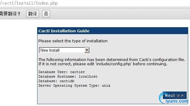

  [9]安装cacti
  本来是打算用编译的方式安装的;不过考虑到实操的系统是el4,着实太老旧了点儿;就试试yum方式成不成,没成想,有了dag源后,cacti也可以yum安装了;而且发现cacti官网截至06.20.2012下载页面http://www.cacti.net/download_cacti.php显示的latest version: 0.8.8a和yum方式安装的版本一样;
  [iyunv@w ~]# yum install cacti Setting up Install Process Setting up repositories dag                       100% |=========================| 1.9 kB    00:00     base                      100% |=========================| 1.1 kB    00:00     update                    100% |=========================|  951 B    00:00     Reading repository metadata in from local files Parsing package install arguments Resolving Dependencies --> Populating transaction set with selected packages. Please wait. ---> Downloading header for cacti to pack into transaction set. cacti-0.8.8a-1.el4.rf.noa 100% |=========================|  61 kB    00:02     ---> Package cacti.noarch 0:0.8.8a-1.el4.rf set to be updated --> Running transaction check
  Dependencies Resolved
  ============================================================================= Package                 Arch       Version          Repository        Size ============================================================================= Installing: cacti                   noarch     0.8.8a-1.el4.rf  dag               2.2 M
  Transaction Summary ============================================================================= Install      1 Package(s)         Update       0 Package(s)         Remove       0 Package(s)         Total download size: 2.2 M Is this ok [y/N]:
  Downloading Packages: (1/1): cacti-0.8.8a-1.el4 100% |=========================| 2.2 MB    00:34     Running Transaction Test Finished Transaction Test Transaction Test Succeeded Running Transaction   Installing: cacti                        ######################### [1/1]
  Installed: cacti.noarch 0:0.8.8a-1.el4.rf Complete!
  Yum安装的cacti默认位置在:/var/www/cacti;apache虚拟机默认root配置在 /var/www/html;做个软链:
  [iyunv@w html]# ln -s ../cacti/  cacti
  然后迫不及待的在浏览器里:http://**.**.**.**:**/cacti/index.php结果返回报错信息:
  FATAL: Cannot connect to MySQL server on 'localhost'. Please make sure you have specified a valid MySQL database name in 'include/config.php'
  然后这样操作:
  [iyunv@w html]# cd cacti/ [iyunv@w cacti]# pwd /var/www/html/cacti [iyunv@w cacti]# mysql -uroot -p cactidb <cacti.sql Enter password: [iyunv@w cacti]# mysql -uroot -p cactidb <cacti.sql Enter password: ERROR 1050 (42S01) at line 5: Table 'cdef' already exists You have new mail in /var/spool/mail/root --------------------------------------------
  [iyunv@w cacti]# cd include/
  [iyunv@w include]# vi config.php /* make sure these values refect your actual database/host/user/password */ $database_type = "mysql"; $database_default = "cactidb"; $database_hostname = "localhost"; $database_username = "cactier"; $database_password = "123456"; $database_port = "3306"; $database_ssl = false;

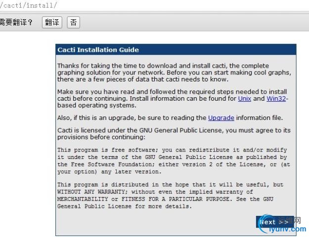

  于是:

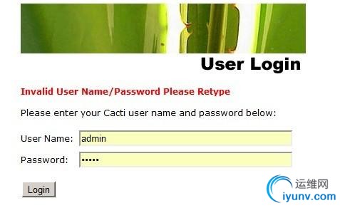

DSC0003.jpg   继续,http://**.**.**.**:**/cacti/index.php登录;默认的用户名密码是admin:admin
  不过填写后点击login却无法登录进去;于是google,于是继续操作:
  #session.save_path = /var/lib/php/session session.save_path = "/tmp"
  [iyunv@w home]# mysql -u root -p cacti Enter password: Welcome to the MySQL monitor.  Commands end with ; or \g. Your MySQL connection id is 186 to server version: 4.1.22
  Type 'help;' or '\h' for help. Type '\c' to clear the buffer.
  mysql> update user_auth set password=md5('admin') where username='admin';
  ERROR 1146 (42S02): Table 'cacti.user_auth' doesn't exist update user_auth set password=Password('yournewpassord')  where username='admin'; update user_auth set password='' where username='admin';
  [iyunv@w home]# mysqlshow cacti -u root -p Enter password: Database: cacti +--------+ | Tables | +--------+
  [iyunv@w cacti]# mysql -u root -p Enter password: Welcome to the MySQL monitor.  Commands end with ; or \g. Your MySQL connection id is 653 to server version: 4.1.22 Type 'help;' or '\h' for help. Type '\c' to clear the buffer. mysql> use cactidb; Reading table information for completion of table and column names You can turn off this feature to get a quicker startup with -A Database changed mysql> show tables; +---------------------------+ | Tables_in_cactidb         | +---------------------------+ | cdef                      | | cdef_items                | | colors                    | | data_input                | | data_input_data           | | data_input_fields         | | data_local                | | data_template             | | data_template_data        | | data_template_data_rra    | | data_template_rrd         | | graph_local               | | graph_template_input      | | graph_template_input_defs | | graph_templates           | | graph_templates_gprint    | | graph_templates_graph     | | graph_templates_item      | | graph_tree                | | graph_tree_items          | | host                      | | host_graph                | | host_snmp_cache           | | host_snmp_query           | | host_template             | | host_template_graph       | | host_template_snmp_query  | | plugin_config             | | plugin_db_changes         | | plugin_hooks              | | plugin_realms             | | poller                    | | poller_command            | | poller_item               | | poller_output             | | poller_reindex            | | poller_time               | | rra                       | | rra_cf                    | | settings                  | | settings_graphs           | | settings_tree             | | snmp_query                | | snmp_query_graph          | | snmp_query_graph_rrd      | | snmp_query_graph_rrd_sv   | | snmp_query_graph_sv       | | user_auth                 | | user_auth_perms           | | user_auth_realm           | | user_log                  | | version                   | +---------------------------+ 52 rows in set (0.00 sec)
  没效果,继续:
  [iyunv@w html]# chmod 777 /var/lib/php/session [iyunv@w html]# ll /var/lib/php/session total 0 [iyunv@w html]# pwd /var/www/html [iyunv@w html]# cd /var/lib/php [iyunv@w php]# ll total 8 drwxrwxrwx  2 root apache 4096 Feb  3 07:56 session [iyunv@w php]#

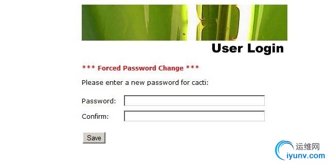

  这样,终于可以登录进去了;进去后首先强制要求修改密码:
  修改密码后,验证旧密码: DSC0005.jpg

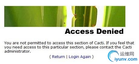

  创建一个新的普通用户并尝试登录:
  权限不足够,赋予权限:

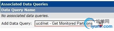

  使用cacti默认模版监控磁盘使用情况,首先当你新建了一个设备后,在配置页面最下方有关联数据源的配置,要首先选择这里
DSC0008.jpg --- DSC0009.jpg .....
  然后在snmpd.conf中找到disk checks段,添加待监控分区,比如: disk /
  修改完配置文件后,重启snmpd服务;
  [iyunv@s snmp]# service snmpd restart 停止 snmpd:[  确定  ] 启动 snmpd:[  确定  ]
  如果不做上述设置,有情况下可能会报错:No SNMP data returned
