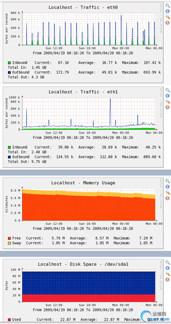

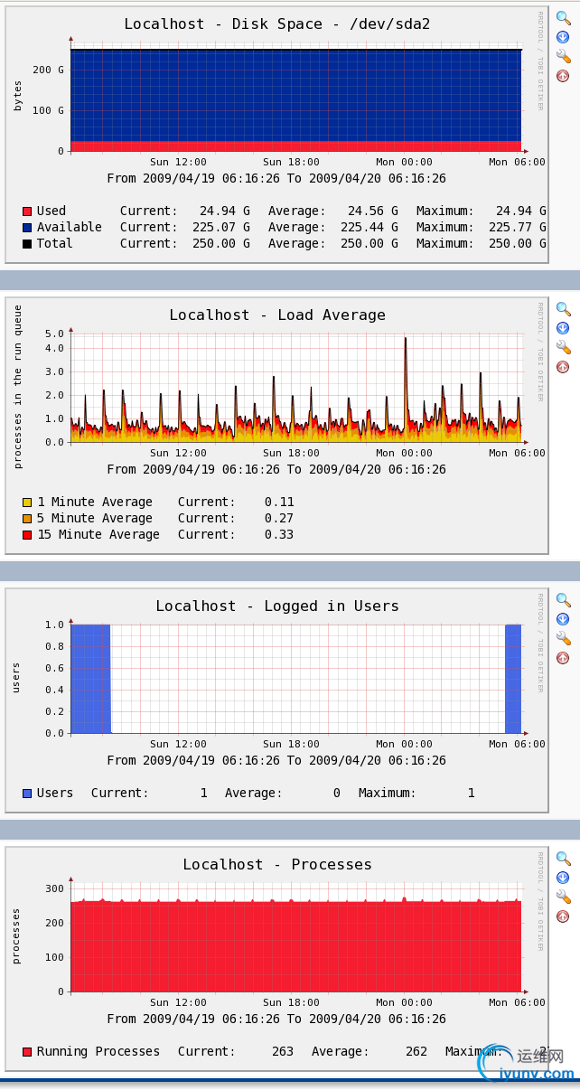

  To view graphs click on Graphs tab. Here is sample graph from one my own box:
DSC0002.png Fig.02: Cacti in Action - Memory, CPU and Network Usage
(Fig.02: Cacti in action)
Fig.03: Cacti in Action Disk, Load average and User stats
