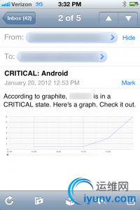

  Just to be clear, we’re going to set things up so you can get alert messages from Nagios that look like this (click to enlarge):

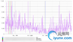

  And you’ll also be able to track those alert events in Graphite in graphs that look like this (click to enlarge, and note the vertical lines – those are the alert events.):

  • It pings back to graphite to record the alert itself as an event, so you can define a graph for, say, ‘Apache Load’, and if you use this script to alert on that metric, you can also overlay the alert events on top of the ‘Apache Load’ graph, and vet that alerts are going out when you expect. It’s also a good test to see that you’re actually getting the alerts this script tries to send, and that they’re not being dropped or seriously delayed.
